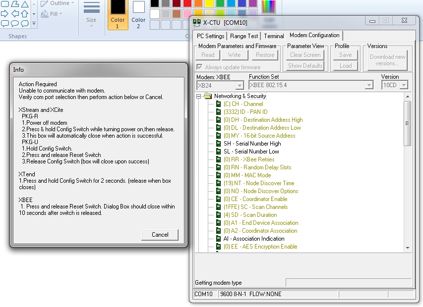

I ordered an SKXBee and an XBee from Cytron. I could read the serial address of my SKXBee using X-CTU, but the XBee antenna is soldered to the board so i cannot configure my another XBee antenna. I'm using another starter kit board borrowed from my friend to install my XBee antenna so i can read it from X-CTU, but still 'unable to communicate with modem'. I tried to flash it using this way viewtopic.php?f=10&t=3380, but still when i release the reset button, the box did not disappear.
COM port is correctly selected, baud rate correctly selected, every settings are the same as instructed in the forum site.
P.S. The SKXBee should not be made in such a way that XBee antenna is soldered so firmly on the board, it should be completed with female 2mm pin headers so that the XBee is detachable and users can use the Starter Kit board to configure another XBee anternna. :evil:
After reset button is released, the box does not disappear.
