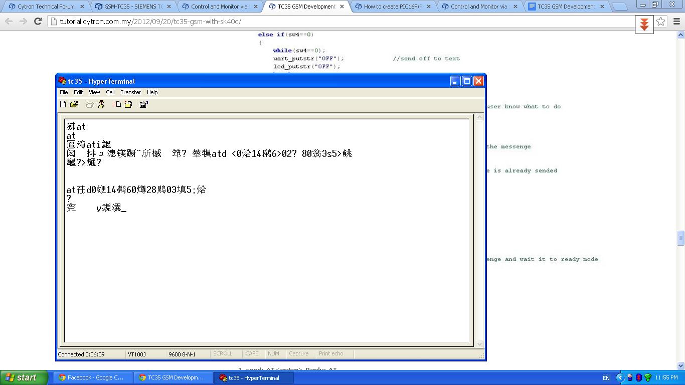

Printscreen the Hyperterminal and show us.
Re: Can't display proper character for hyperterminal
Postby Ferdinand91 » Fri Nov 16, 2012 12:18 am
i type the 1st row is AT and i press enter it come out chinese word

Never see this, but 1 weird setting is the "VT100J" under the HyperTerminal window, beside the 9600-N-1. Normally is Auto-detect or ANSI or ANSIW 8-)
Try to change it and check whether it is fixed, not sure is that setting causing the problem.
Goto File->Properties, the Properties window will appear, click the Settings tab, You will see Emulation dropbox, choose ANSI or ANSIW, and click OK.
