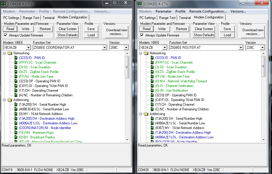

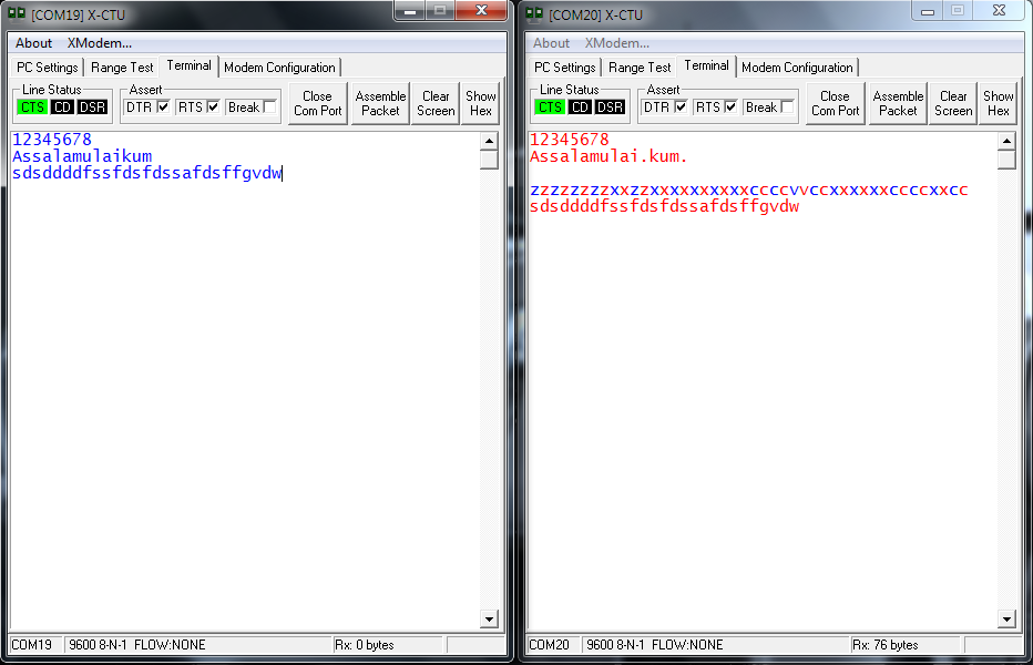

2) I also have check the communication between XBee using X-CTU software and it work fine.. (It can communicate : See Attachment )
3) Refer to attachment 1, i configure the XBee based on tutorial at UTube
4) Refer to attachment 2, i think that only XBee#1(COM19) can transmit data and XBee#2(COM20) can only received.. Pleased verify.

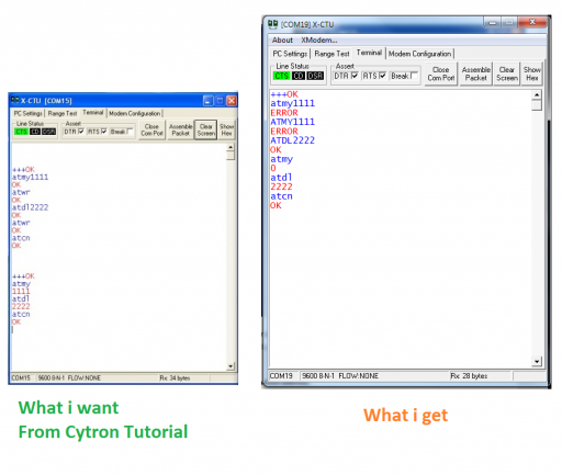

5) I have look tutorial and Coding from Cytron, i want to use comment "ATMY1111" but i always get "ERROR", anyone have idea what the problem. (Refer to Attachment 3)

I have found the problem, The problem is XBee#1 only transmit data while XBee#2 only received data.. So anyone have idea how to make both XBee can transmit and received. I think the problem about the configuration especially the part like ATTACHMENT 3.

Make ATMY and ATDL same number.

In that case, you did not swap the SKXBee to verify it is bi-directional :)
BTW, you are using Series 2 right? It is not the same as series 1, do you know that?
I think cytron did a tutorial on how to configure series 2 XBee, you should check that out.

i have the same problem before...my xbee1 cannot detect what my xbee2 is transmitting ..i follow all the instruction from cytron tutorial...u know what i did? i restore all the data back to original ( Xbee )..then i just set he PAN ID only ( both must be set same number....the others is in default setting... it works realy2 well.. i can communicate from my pc via xbee to my arduino :)
im using XBEE S2..
