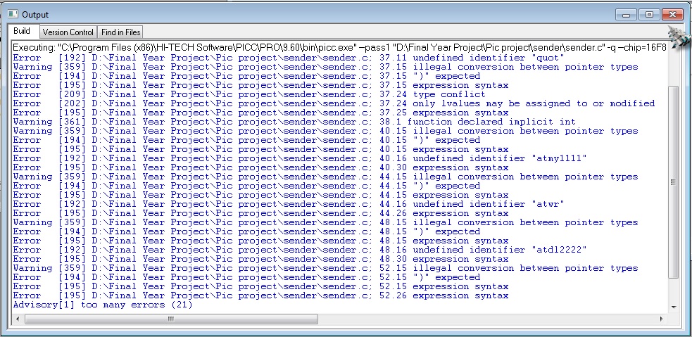

i have write the code same like the tutorial at http://tutorial.cytron.com.my/2011/07/3 ... ontroller/ but there are some error..i don't know where the mistake..because this is first time i try to write in C..can u help me..

Show us the error shown by compiler at output

Postby atikahIsmail » Wed Nov 20, 2013 7:16 pm
this is the error..i still looking to solve this error..but i still can't find this

Postby yonghui » Thu Nov 21, 2013 11:33 am
U didnt write ur code properly. Double click the error in output to bring u to the line that contains error. Or find the error shown by report, got line and column there. 1st significant one u don't declare ur variable quot before use
