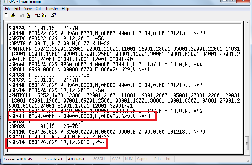

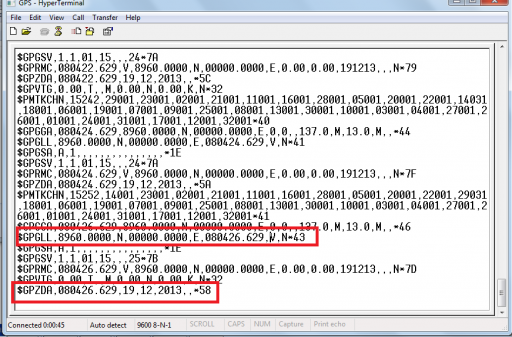

i have brought a GPS kit and UART converter (UC00A) when i interface the GPS with my laptop,the output only give date and time but the location didn't show the exact loccation.The com port is correct!!!
interface using hyperterminal

hokelvin66 WROTE:i have brought a GPS kit and UART converter (UC00A) when i interface the GPS with my laptop,the output only give date and time but the location didn't show the exact loccation.The com port is correct!!!
That is default location. The gps not lock location yet. You can try on longger or find another place.

thx,i had solve it by moving to other place thx :D
