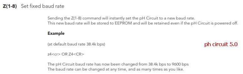

Postby sahniana » Wed Jun 04, 2014 12:29 pm
for ph circuit 5.0, to change baudrate from 38400 to 9600
1. connect at default baudrate 38400.
2. send "z4" + <cr> @ chr(13)
3. disconnect.
4. connect at baudrate 9600.
