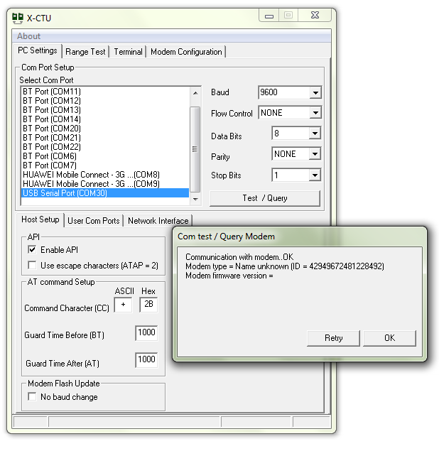

hi, I am facing the same problem unable to communicate with modem. I am using XBee module ( Not SKBEE) . I did connect the minimum pin for update firmware which is VCC, Din, Dout, GND, RTS, and DTR.
enable API box is unchecked
enable API box is checed
After checked the enable API box the modem can communicate but modem type and firmware unknow. ( Not same with SKBEE) is it I need load the firmware first ? XBee 1mW Wire Antenna . What firmware should I load ? XB24 ? function set ? version ?

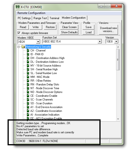

I have try the method follow SKBEE firmware corruption restore method and using the function set and firmware version in FAQ. But it still come out withe these command.
Getting modem type....Programming modem...OK
No AT parameters to set
Detected baud rate difference.
Make sure PC and modem baud rate is set correctly
Write Parameters...Complete
The SKBEE firmware version same with XBEE Module ?
