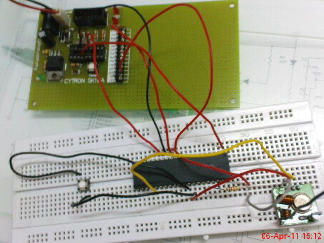

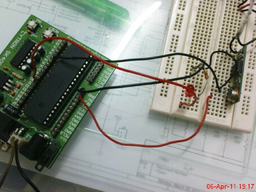

Re: Need help in RF module problem
Postby cheehao » Wed Apr 06, 2011 7:31 pm
sry for the no clear picture...since i am using development board..so i just doing a simple connection for an led only..
i can explain to u if u have question on it...
