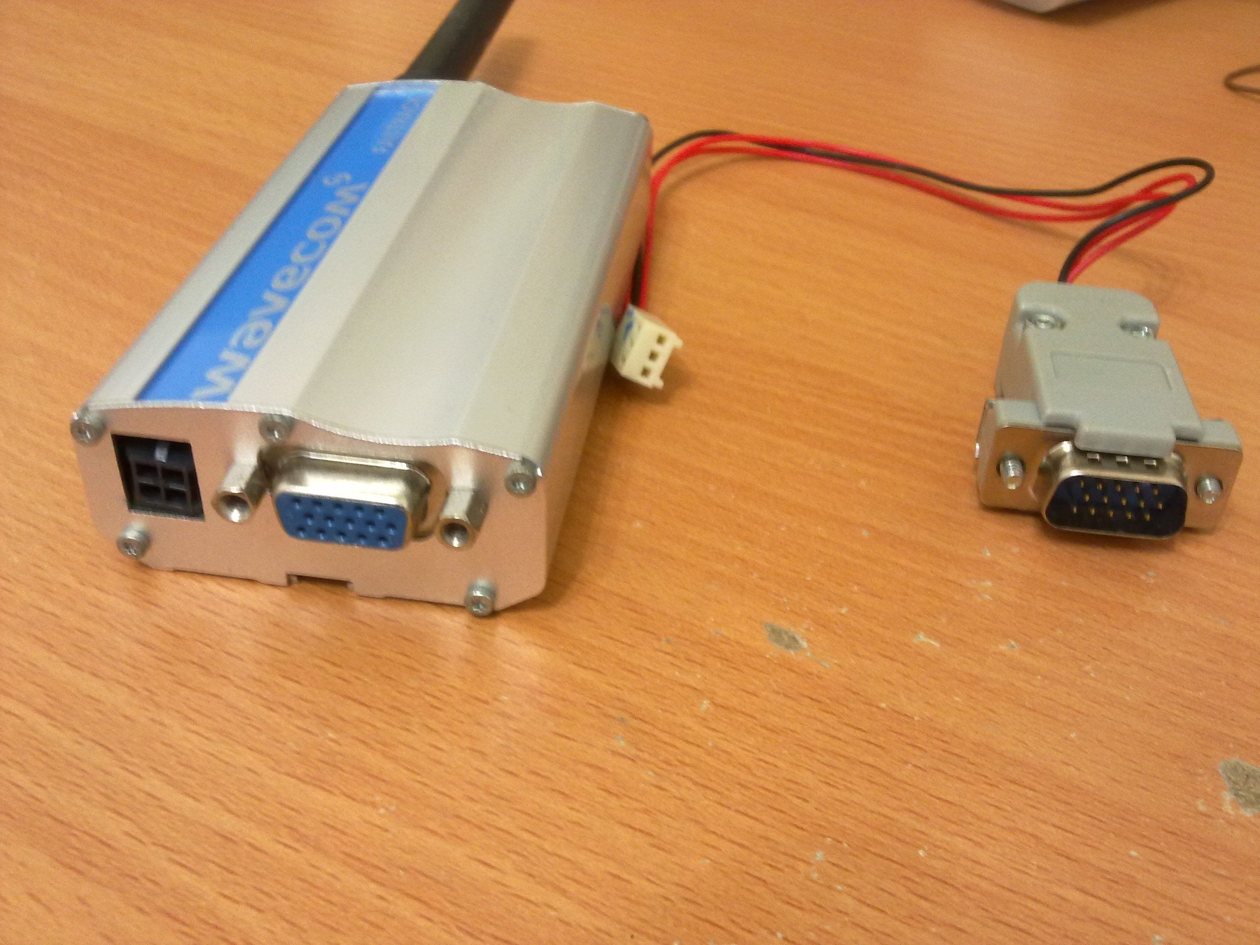

yes i tried, but couldn't get a response..the gsm modem i'm using has a db15 connector. since i dont have a bd15 to usb cable, i connected the gsm to max232, which was connected to UC00B (USB to UART converter)...

I thought the GSM come with the cable for COM port connection?
A few photos of interface should be helpful.

this is the picture of the modem and the cable that came with it

      *buffer++ = rec_data;
   } while (rec_data != '\n');
rizwan_elias
Joined: Wed Nov 30, 2011 1:58 pm
Re: GSM problem need help plzzzzzzz
Postby shahrul » Tue Sep 25, 2012 10:49 pm
I think, call ready when the GSM Modem power up. If you miss to check this, then there is no more 'call ready' reply. I never use this command.
Postby rizwan_elias » Tue Sep 25, 2012 11:42 pm
shahrul i dont get u..are u saying i should delete that part from the code?
rizwan_elias
Postby shahrul » Wed Sep 26, 2012 9:08 am
rizwan_elias WROTE:shahrul i dont get u..are u saying i should delete that part from the code?
I don't know. In doing programming, you can try-and-error code many many times. So, you can try disable that part and find out why it's stuck. This ex GSM Modem.
