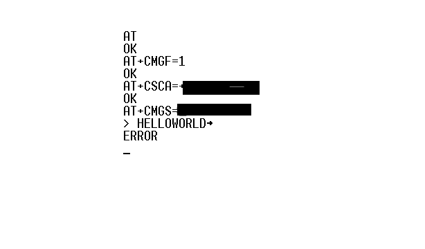

i am using TC35GSM which bought found cytron, can i using RS232 series converter connected between laptop and GSM? since i had try it out for sending a sms in hyperterminal. everything goes fine but there was an error when i press ctrl+z. Can everyone help me thank you.

from the cytron user manual guild, they are using UART to RS232 converter connected between laptop and GSM but for me, i using USB to serial converter connected between of them. what is the different between of this two device? is it the error occur because by different type of communication cable? thank you. on the other simple way, connect them between computer desktop and gsm, this i never try it out. may be able sending sms.

i can making call !!! but cant send sms. am i wrote a wrong AT commend? AT+CSCA=+601xxxxxxxx <my phone number> then AT+CMGS=01xxxxxxxx <target num>. i already ensure the jumper connecting T0 and T1, and GSM is successfully connected the sim card. even i had try to press small letter of 'z', it still error. Then at the hyperterminal setting baud rate=9600, 8 bit,none parity,none flow control,one stop bit. i totally following the instruction provided by cytron, i had no way to solve this problem. is this product got some problem? i just purchase this last 4 days only.

Postby zhenning » Sat Dec 08, 2012 4:19 pm
Have you see this: http://tutorial.cytron.com.my/2012/09/2 ... ith-sk40c/
Explanation:
To send sms
1. send: AT<enter> Reply: AT
2. Send: AT+CMGF=1<enter> Reply;AT+CMGF=1 (SWITCH TO TEXT MODE)
3. Send: AT+CSCA=<messengers services center number> <Enter>
Reply: AT+CSCA=<messengers services center number>(set number)
4. Send: AT+CMGS=<target number><enter>
Reply: AT+CMGS=<target number> (target phone number)
Reply: >
5. key in the messenger u want and send by sending as ending 0x1A
Reply: +CMGS: XXX
Hope this helps ;)

Postby wayne » Sat Dec 08, 2012 4:48 pm
dear zhenning, actually i refering this AT commend that you post. what is 0x1A? i think this is equal to (ctrl+z) and normally 0x1A is use in microcontroller C programming to reprenseted as (ctrl+z). am i right? by the way, thank a lot give me a helping hand. but i still cant solve this problem until now T_T so sad.

Postby wayne » Sat Dec 08, 2012 5:03 pm
i know where i am wrong. what is mean by messengers service center number? is it represented as my phone number or digi/maxin service number? i write my phone number in AT+CSCA, is it wrong already? thank you much for your all helping hand

Postby wayne » Sat Dec 08, 2012 5:19 pm
finally!!!!!!!!!!! i can send my message!!!!! thank you all your guy
