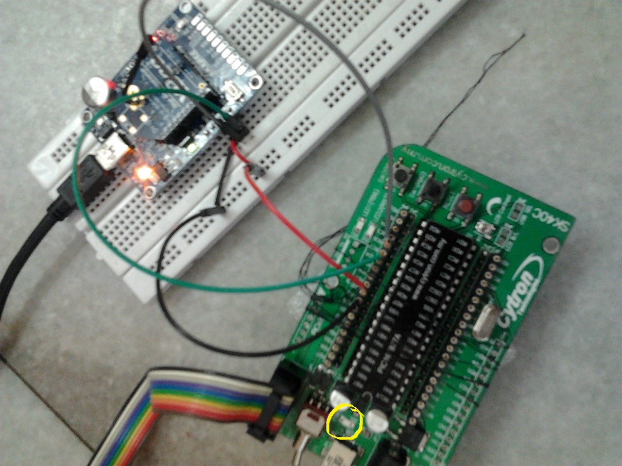

Postby atikahIsmail » Mon Nov 11, 2013 5:59 pm
i have a problem that the sk40c power does not up..suppose the led power will light up when i attach the ac adapter..but the led does not up..but the sk40c is heat..with this i attach with the picture..i have circle the led power that should be light up..

Postby robosang » Mon Nov 11, 2013 10:55 pm
Brother, you know how to use breadboard or not? The 5V and GND from SK40C is being shorted together on the breadboard lah! You check with multimeter first! You have probably broken the SK40C voltage regulator, PIC, and maybe the SKXbee too.
Frankly, I am surprised to see this!
That is the reason why picture of actual hardware/wiring is needed. Schematic is a story, when you connect it using wiring is another story.
