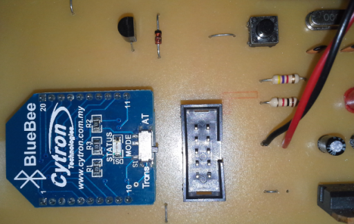

i already had bought Bluebee Bluetooth Module from cytron, i had a problem with BlueBee Bluetooth Module, where "bluebee name" it does not appear on my android when i turning on the bluetooth, can u help me for the solution?
when i started on the power supply connected to my hardware , i noticed that the bluebee bluetooth module started blinking at the "TRANS MODE" blinking fast. After that, i on bluetooth of my android, by searching name of Bluebee Bluetooth Module..to pairing with my android,thus, from here i cannot detected any device or name of bluebee bluetooth module in my andrOID.

If you referring to the bluebee datasheet, the default name for bluebee is "H-C-2010-06-01". Did you find this name or others name of bluetooth when you searching by your Android phone?

Mr idris, There is no name or bluebee default number come out on my bluetooth android..

afiq91 WROTE:Mr idris, There is no name or bluebee default number come out on my bluetooth android..
Thanks for your verification, most probably the problem comes from the module itself, our support team will follow up your case.

Could you show us your schematic diagram? just want to verify the bluetooth connection.
