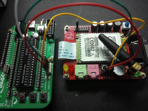

i was having problem with the gsm. i have built the program given but cytron tutorial. but the gsm was unable to make call and sms.
the gsm modem was able to in ready mode when did not connect to the pic.
once i connect the pic via sk40c. when i turn on my pic power, about after 30 sec the gsm yellow light will be blinking(not in ready mode)
i just modify the given program sw1 and sw2 from rc0 and rc1 change to rb0 and rb1. and then change the number of calling. when i turn on the power. gsm is able to function in ready mode.
once i press sw1(RB0) the yellow indicator keep on blinking.
please refer the the program code.

Which yellow LED? Is label D6?
LED D6 will need to be blinking in following rate to indicate the GSM modem and SIM card is ready:
ON for 75ms (short) and OFF for 3 seconds
If the LED D6 is blinking around 600ms ON and 600ms OFF means the SIM card is not detected or not inserted properly, or the modem is searching for the service provider such as Celcom, Digi, Maxis or any other same service provider.
You do not need to connect to microcontroller for the modem to search for SIM card and service provider. Just the power to the TC35 modem and the SIM card is good enough. This has nothing to do with the microcontroller, pressing switch or not. So ignore the microcontroller first. Make sure the LED D6 blinking to indicate the SIM card is ready before proceed to microcontroller.

hi,
they is no prblem with the signal. if i connect to the laptop via hyper terminal everything is fine.
problem occur when i interface with the sk40c board. i connect the 4 wires (Vdd, Gnd, RXD and TXD) on the gsm to the sk40c board. i follow the TC35 GSM Development Board User's Manual Rev2 instruction. power adapter is connected to each ( Gsm and sk40c).
when i turn on the power for sk40c board, about 30sec after the gsm D6 led will blink the LED D6 is blinking around 600ms ON and 600ms OFF. what happen? since it able to function properly via hyper terminal then still the SIM card is not detected or not inserted properly, or the modem is searching for the service provider such as Celcom, Digi, Maxis or any other same service provider. ?
please advice

So you are saying you can send SMS or make call if the GSM modem is connected to laptop? And the D6 LED is showing the SIM card is ready with ON for short and OFF for long period? But after connect to SK40C and you activate the power, the GSM showing the SIM card is not detected?
Posts: 1447
Re: GSM-TC35 + PIC16F877A + SK40C
Postby vinctal910713 » Thu Mar 27, 2014 8:32 pm
yes gsm modem can send sms or make call when i connected to laptop.
the problem occurs when i connect to the SK40C
when i connect to SK40C,the LED D6 is blinking around 600ms ON and 600ms OFF. what is the problem? should not be the SIM card is not detected.
please advice.

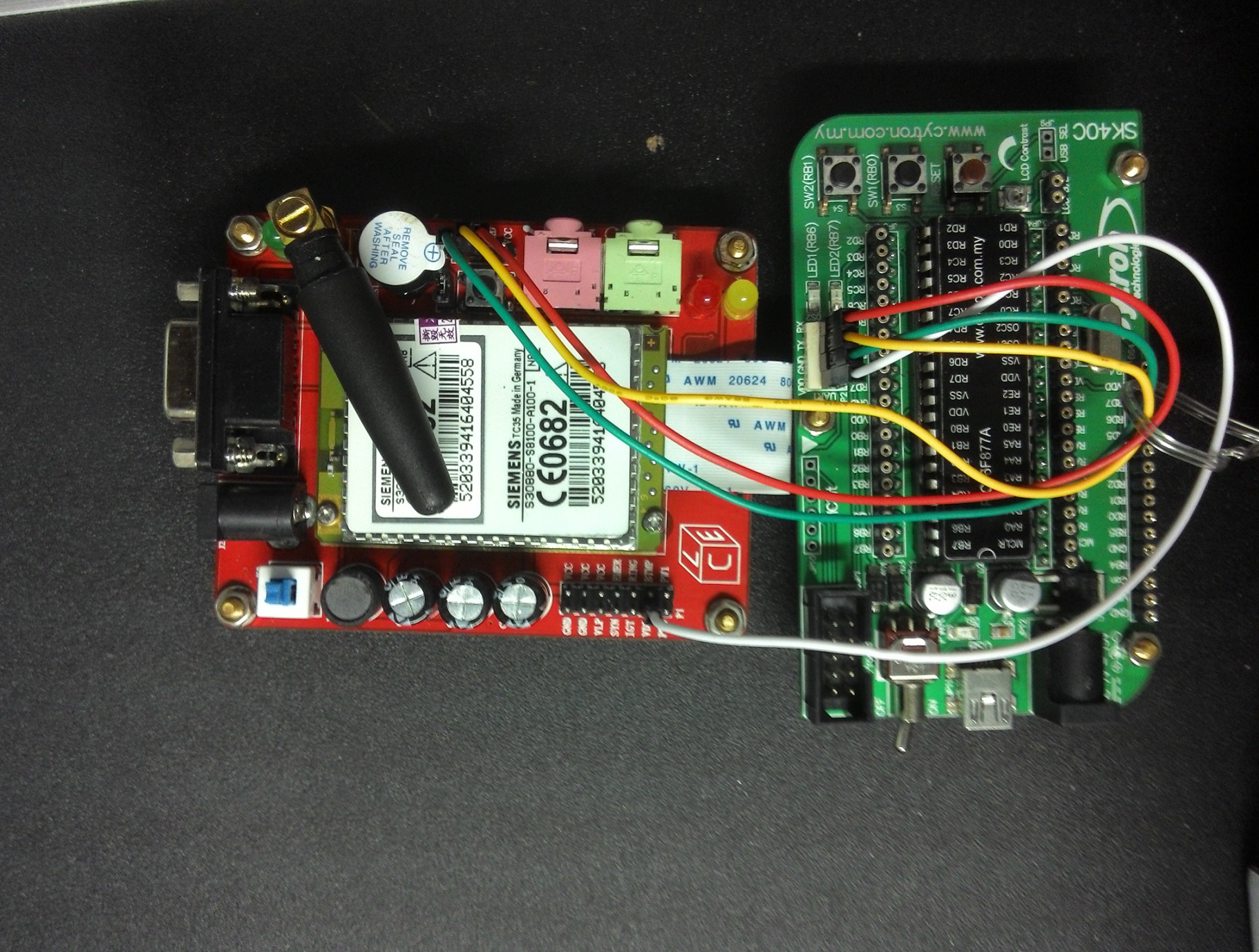

Postby ober » Thu Mar 27, 2014 10:52 pm
In that case, please capture a clear photo of the wiring connections. Do let us check the wiring.

Postby vinctal910713 » Fri Mar 28, 2014 12:43 am
all the connect i follow the TC35 GSM Development Board User's Manual Rev2 instruction.

Postby ober » Fri Mar 28, 2014 7:24 am
I think the connection in User's Manual have mistake, we will correct it.
Move the white jumper (from VDD of SK40C) to VCC (The last pin of 4 pin UART header pin) on TC35 GSM board, together with other 3 jumpers wires. So all 4 jumper wires should be together.
Try it again.
Posts: 1447
Postby vinctal910713 » Fri Mar 28, 2014 7:35 pm
hi ,
now the gsm can interface with sk40c.( the gsm led d6 show normal when the sk40c supply turn on) but still cant make a call or sms. i have try to load the SAMPLE SOURCE CODE project 1 and 2. but the gsm did not send sms or call.
