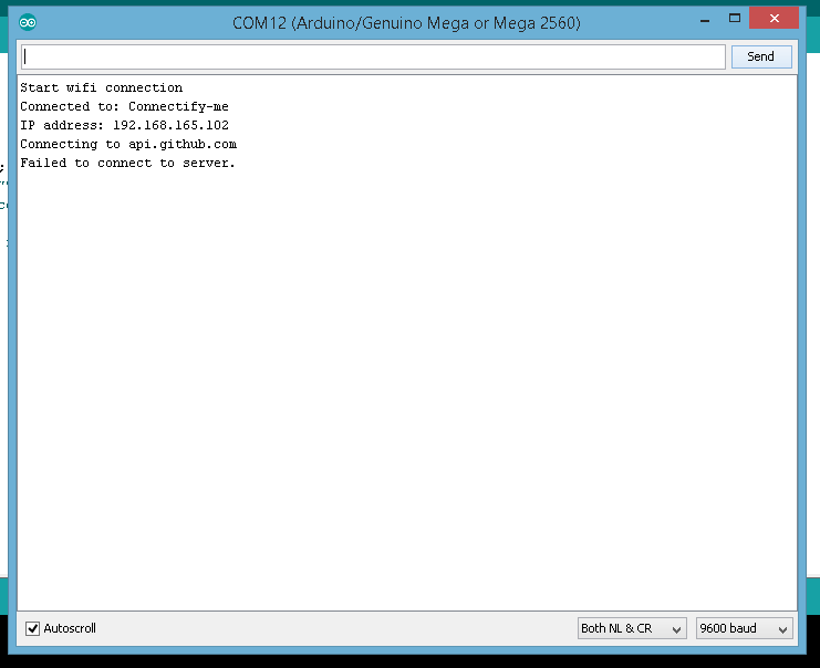

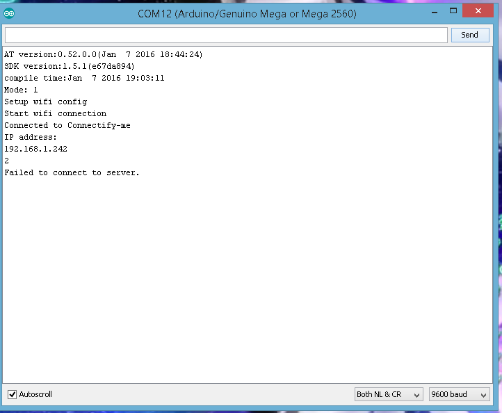

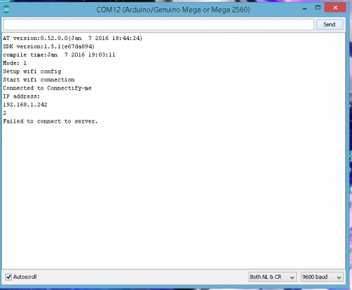

I just bought Cytron Wifi Shield Rev2.0 last week. I used it with Arduino Mega2560. I got no problem connecting to wifi. However, i have a problem to connect the arduino to a server as a client. I just try to run the all the client example, it give respond "Failed to connect to server". I run HTTPSClient example, HTTPSGoogleform example and CytronWifiDemo example and all of it give the same respond.

The other code is the same as the example in the library. By the way, i also try to run the SimpleWifiWebserver example, it can run smoothly.
Can anyone help me to solve this problem. This is because i want to use client library for my project. Thank you in advance.

Lets try with CytronWiFiDemo sketch first for HTTP connection as client first. We will deal with HTTPS connection later on. In the sketch try to comment/remove the line wifi.config(ip) to allow wifi shield to get random IP address assigned by your network router.

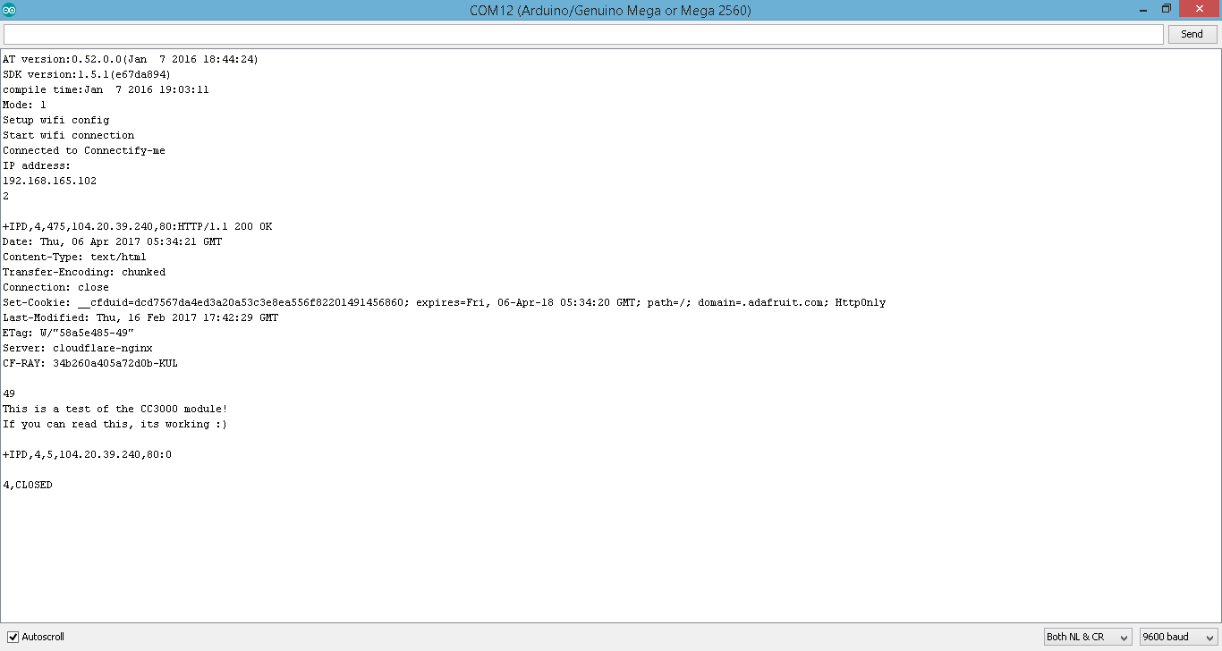

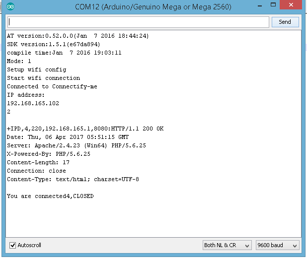

Wow! it is working!! Thank you very much! I also try to make a connection to my local server and it is working...this is really helping me... btw, can u tell me why wifi.config is not working in the sketch? and also what is the possible problem for the https example?
Here i attach the response of the sketch

It is because of your network IP address. If you wish to use static IP address, you can use wifi.config(ip). However, you should change IP address ip in form 192.168.165.xxx instead of 192.168.1.xxx. But if you wish not to use static IP address, you can just ignore it.
