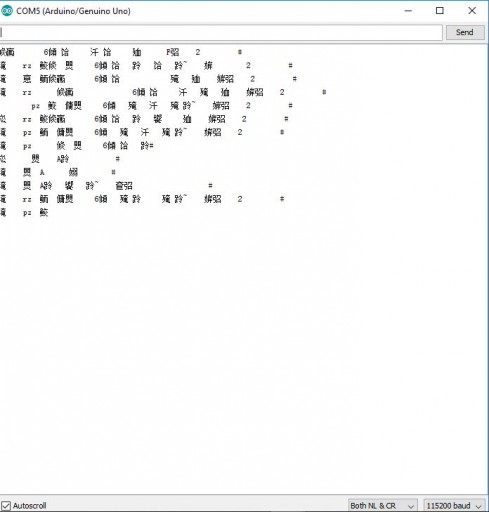

Postby Lim » Thu Apr 06, 2017 11:13 pm
Hi, i have tried to change the at+UART, and it response ok, then after that i change the serial monitor baud rate to115200, i type any at command but cannot get response, then i try pressing the esp_reset on wifi shield, it shows up this one, i am still using the software serial 2 and 3 ,is it because of that?

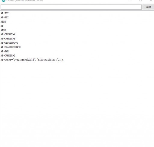

Re: How to change the AT baud rate in cytron wifi shield?
Postby Lim » Fri Apr 07, 2017 1:07 pm
i have received this when doing at test,after that i change the D0 and D1, i cannot upload the sketch,
but if i remove d0 and d1 connection at rx tx,it can upload the sketch,
then i connect again the d0 d1 at wifi shield, but now i cannot send data to the softap alrdy?

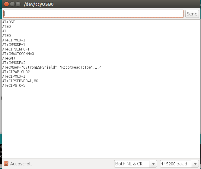

Postby bengchet » Fri Apr 07, 2017 4:33 pm
I have tested and it works properly without problem, see the screenshot below.
You can try test with program attached. If you have UC00C, you can use it for debug purpose.
