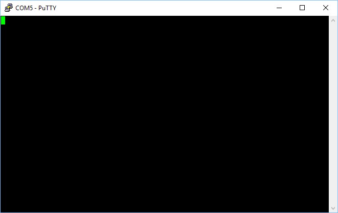

we bought a 915Mhz LORA Gateway https://www.cytron.io/p-hat-lrgw-915....we fixed at raspberry PI (Raasbian OS) . Fixed the Lora gateway on top of it. Power up the raspberry pi and then put the micro sd connect to PC. When we try to link it together by using PUTTY software. it stuck at the black blank screen and we cant type anything. Please help us CYTRON

Postby ArthurWong » Wed Nov 29, 2017 12:46 pm
This is the blank screen
ArthurWong
Joined: Wed Nov 29, 2017 12:39 pm
Re: LoRaWan and LoRa Gateway
Postby bengchet » Thu Nov 30, 2017 10:14 am
Which raspbian OS you are using? Is it downloaded from official website or from here?
If it is from official website, it will not be working because UART on Raspberry Pi is disabled by default.
The link mentioned above is raspbian OS Jessie with gateway softwared pre-installed and UART enabled for debugging. Let's see if changing raspbian OS fix the issue.
