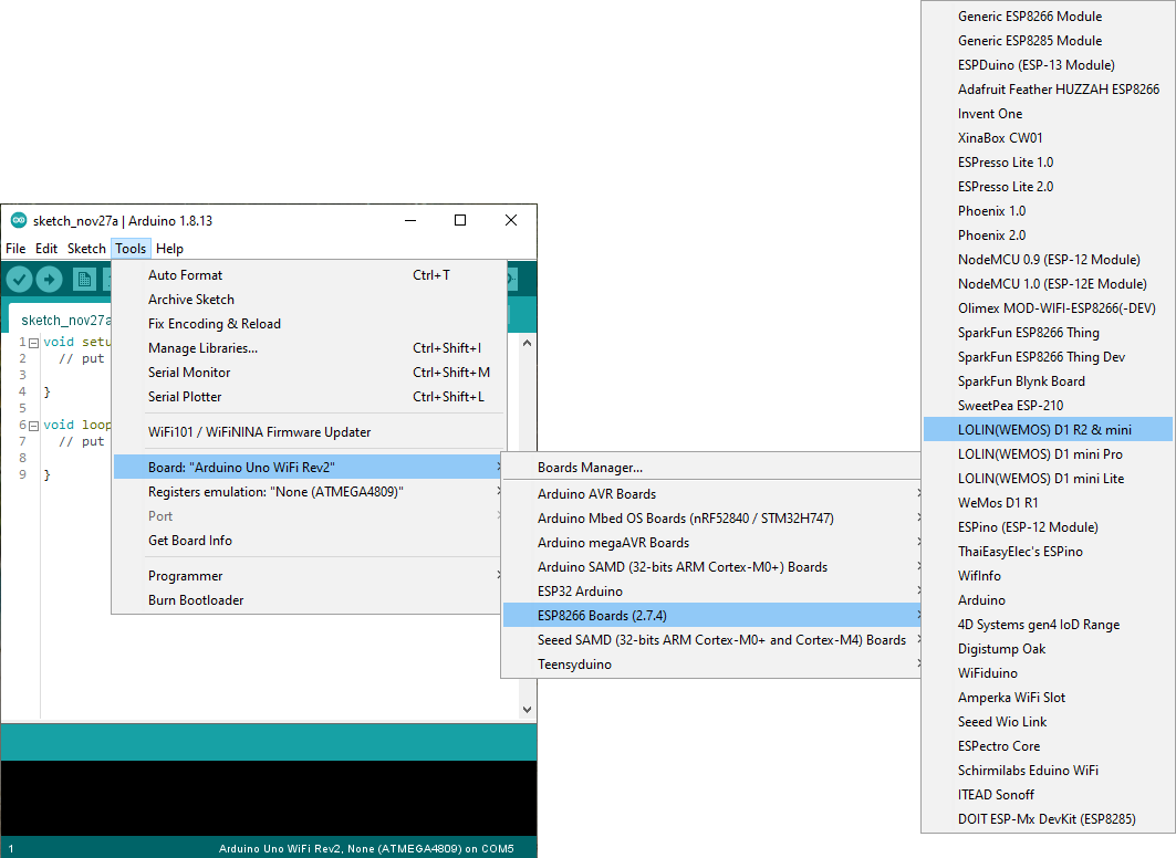

I'm using the latest Arduino IDE 1.8.13. I installed ESP8266 board in Arduino IDE through Boards Manager - https://github.com/esp8266/Arduino#inst ... ds-manager. Then I can select Wemos D1 R2 as shown in the photo below. Maybe you can try this method.
Thanks, hope this helps. :)
