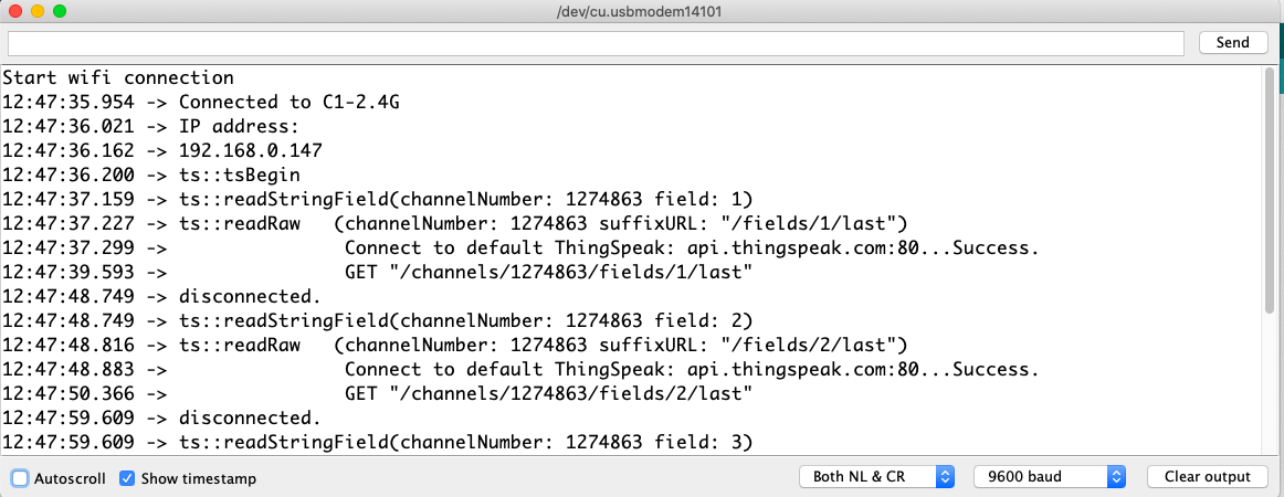

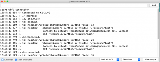

I'm facing a issue in reading the data from ThingSpeak using the WiFiThingSpeak Sketch.
I'm very rarely able to read the sensor data when I connect Arduino Uno and Cytron Wifi Shield Rev 2.0
I checked the ThingSpeak library separately using ESP8266 NodeMCU board and example files of the same library, I'm able to read the data smoothly.
But I'm unable to read using Cytron Wifi Shield Library - WiFiThingSpeak example sketch from my public channel in ThingSpeak
I also verified my internet connection during my testing.
Kindly help me in this regard.

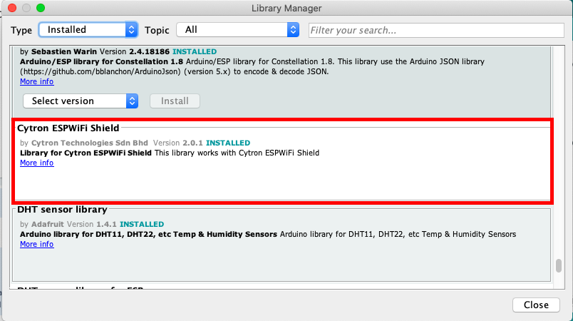

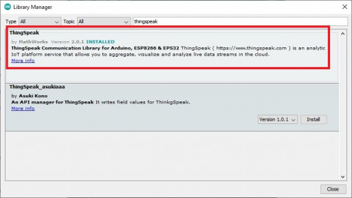

Hardware Setup: Arduino Uno + Cytron Wifi Shield Rev 2 (Based on ESP -WROOM)

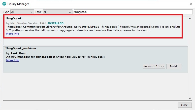

Library: Cytron WifiShield ver 2.0.1 and ThinkSpeak ver 2.01
Example Sketch: "WifiThingSpeak Sketch"

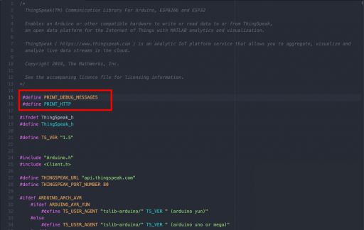

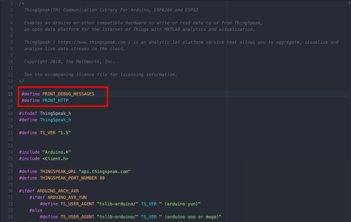

Note: you may uncomment the print statements present in the beginning of "Thingspeak.h" for debugging.

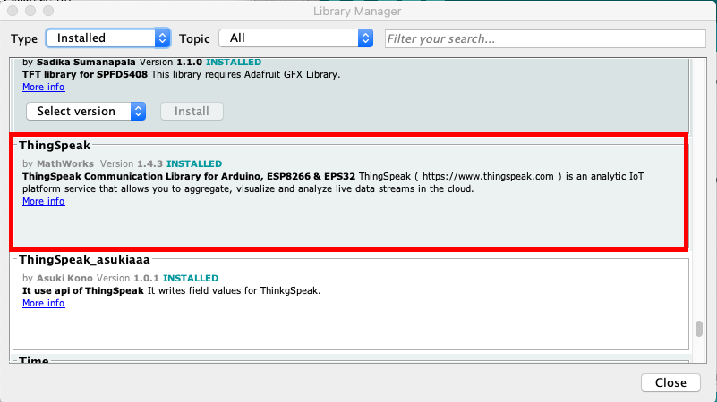

FYI: I found the problem is in the Thingspeak library and I was able to solve this issue when I used the lower version of the Thingspeak Library Ver:1.4.3. However, the problem in the older version is, I'm missing some data while reading from Thingspeak continuously and also some random data pops up which starts with "+IPD...".
As of now, I'm able to receive the data but if you can solve the issue in the latest library as well I would be grateful to you since I dint receive that problem when I tried with "NodeMCU Board" and latest library of "Thingspeak ver 2.0.1"

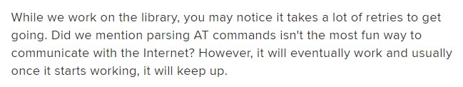

To deep dive the library it will really time consuming. Yes, NodeMCU will do a better job because it is not involve AT commands.
*This statement from Adafruit that talk about ESP AT commands.
Anyway, I've try write and read example under AT commands (ThingSpeak - ESP8266 - AT commands). It works but it need few tries before succeed.
