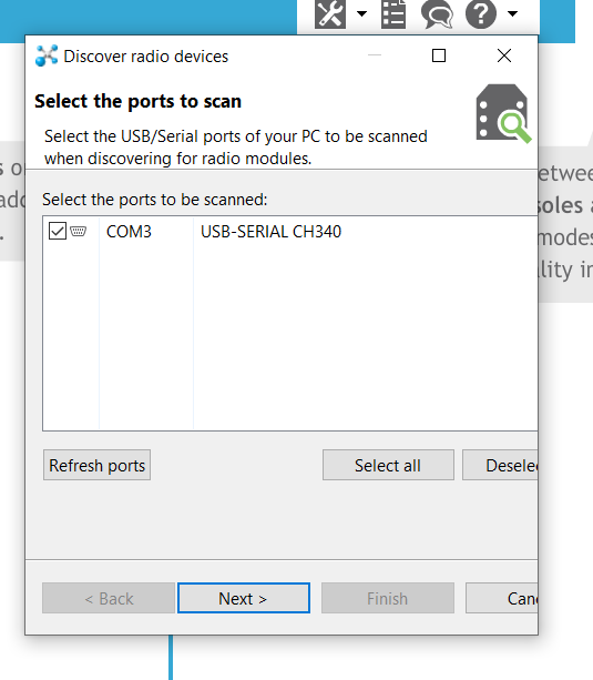

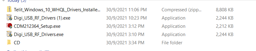

I had already install so many driver by refer from internet but my Ports (COM & LPT) only show USB -SERIAL CH340 (COM3)
My device is using the Arduino Uno, XBee S2C and Cytron XBee Sheild S4A03. This cause XCTU app discover the radio modules.
Anyone know what should I do :| !!
Port showing on the device manager
Screenshot 2021-09-30 232928.png (15.27 KiB) Viewed 28093 times
The discover radio mudules port showing
The drive that I had installed

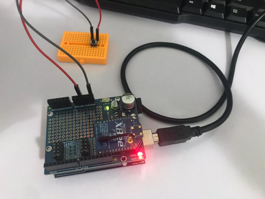

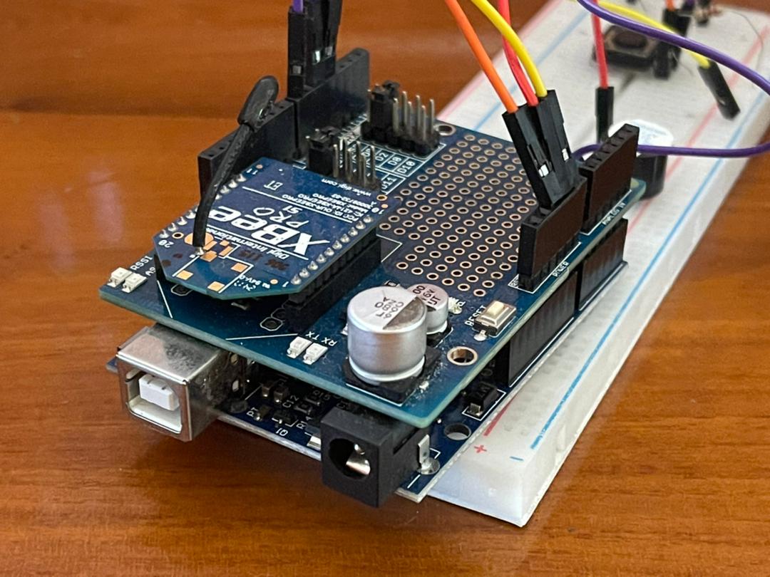

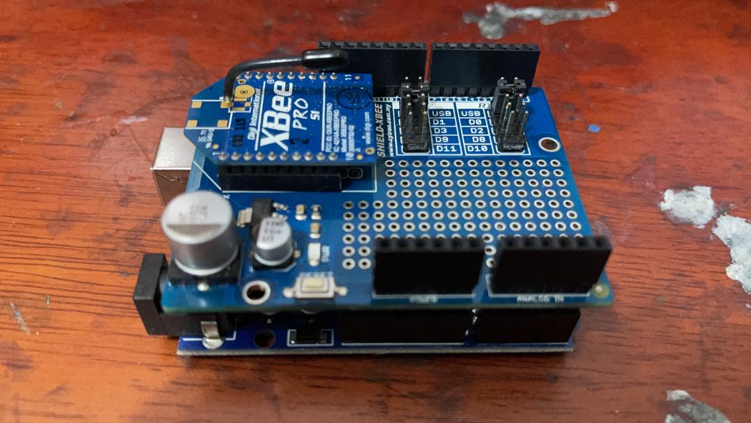

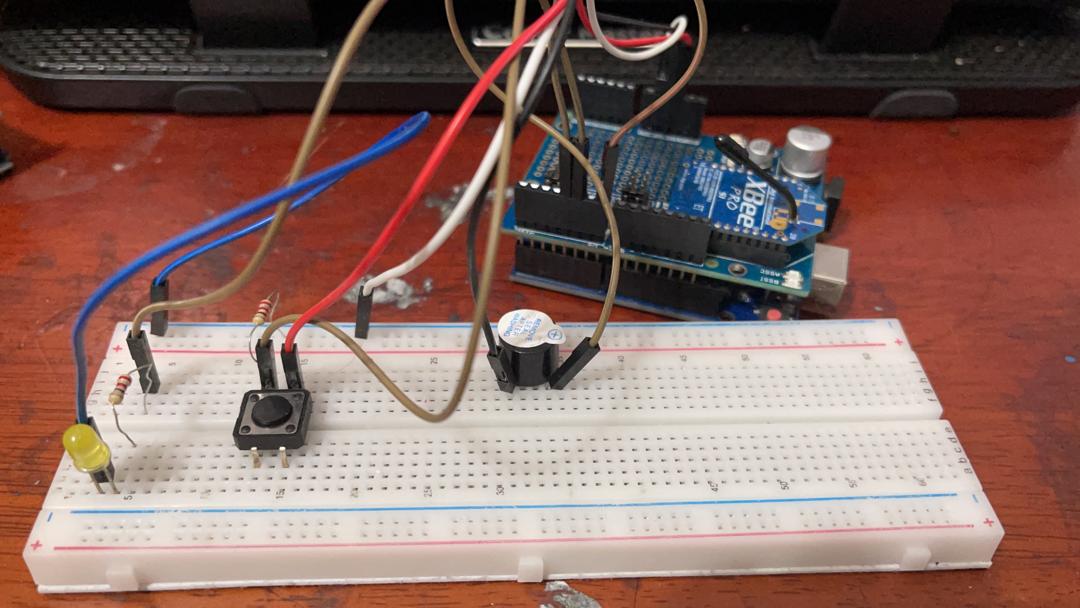

Postby Ming Hao » Wed Oct 06, 2021 4:04 pm
These picture is my hardware setup

Postby ober » Thu Oct 07, 2021 3:28 pm
OK, you wanted to use the USB to Serial on the Arduino to communicate with the XBee on the shield. You need to make sure both the mini jumpers are at "USB" and the Arduino needs to be in RESET state. This is because the UART pins of Arduino are connected to the USB serial pins too.
To Reset the Arduino, simply use a jumper wire to short RST of Arduino to GND.

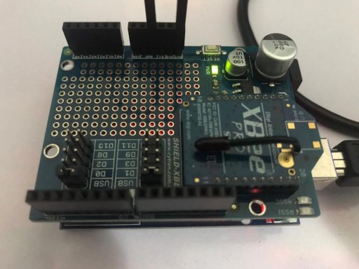

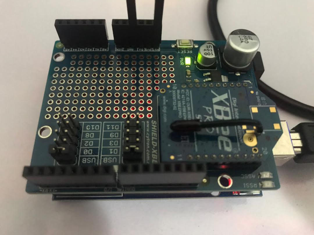

Postby Ming Hao » Wed Oct 13, 2021 7:04 pm
Hi, I have tried the suggested ways, the XBEE is still not discovered, below is the image of the circuit
-> mini jumpers are at "USB"
-> have made arduino to RESET state

Postby ober » Thu Oct 14, 2021 7:36 am
Em... Why there is push button? Just short both the jumper wires together.
