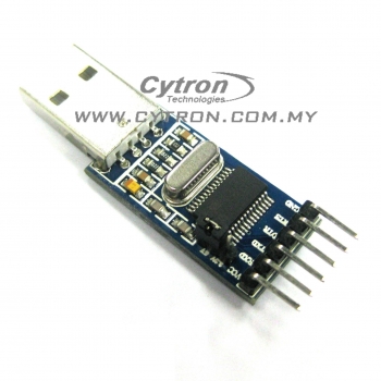

Postby ABSF » Sun Dec 04, 2011 8:37 pm
jenshen418 WROTE:may i know how to connect PC to RFID/PLC (RS232) through UART?
Using UC00B from cytron.
UC00B USB-UART interface
To connect the PLC to PC, you'll need to add a UART to RS232 converter chip called MAX232 to UC00B above. Try googling MAX232 to see the connection and datasheet. If you're able to find USB-RS232 interface elsewhere, then MAX232 is not needed.
The RFID READER - RS232 from cytron already has the RS232 built in so it just goes into the COM port of your PC if there is one (correct me if I am wrong). OR else you'll need a second UC00B to connect the RFID to your PC.
Re: How to link RFID to PLC?
Postby jenshen418 » Sun Dec 04, 2011 10:37 pm
the PLC i use also using RS232 but my pc onli have 1 RS232 port. How can i connect 2 RS232 (1 is from PLC, 1 is from RFID) in the same time? Sry cz asking so much of question. I dun have much knwledge on this field.
