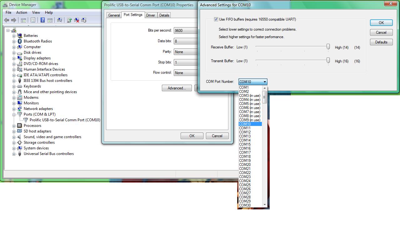

my situation is pretty much the same as chumi's - only that i cannot get the rfid reader to repsond, no sound or light changing to yellow. however i am certain of the port that i'm using, which is 'COM10'. i've checked that using 'device manager'.

Red LED will turn ON when you power it. Buzzer beep and LED change to green when RFID tag is read. You have choose right COM port which is 'COM10'. But maybe you can check your male RS232 converter functionality either can transmit the data to your laptop.
