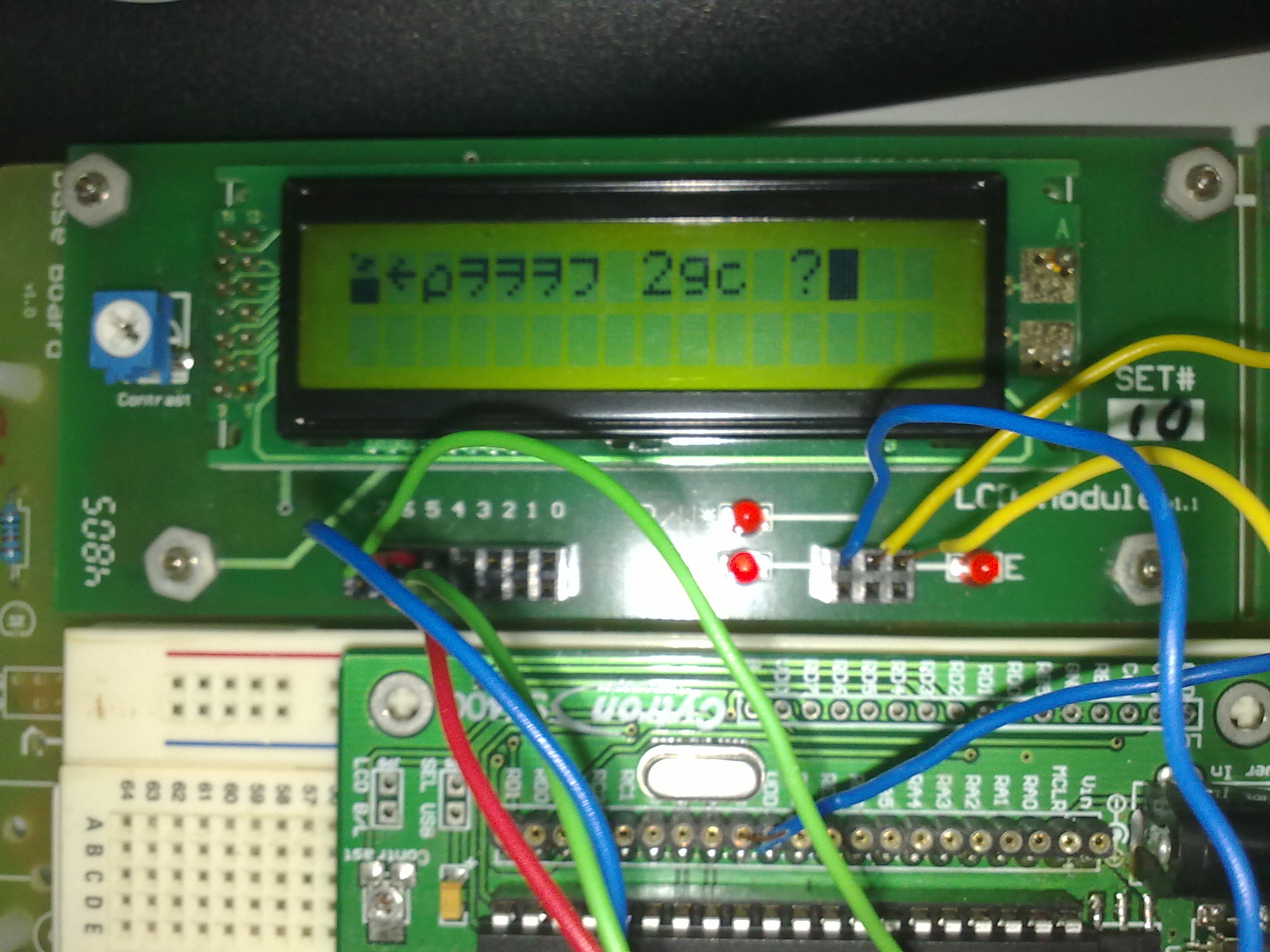

I have compile with MikroC 5.01 to do testing with my PIC16F887 & RFID reader & 16x2 LCD display with following codes:

Everytime, I put near the tag, the LCD shows weird characters shown in the attachment below::
Please anyone can suggestion solutions ?
It's important to me because I'm dealing final year project now.
