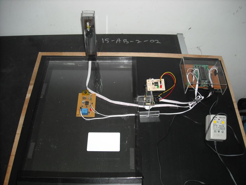

this is my project :
Im making a project based on RFID CR038 and PIC SK40C, using PIC16F877A..
this project is to detect the card when people entering into the parking slot.. and if the card detect it will turn green light on, if the card is not detect it will turn red led on and the buzzer will alarm. i want to ask sir about how can i make the programming that can automatically function that when user enter the parking slot it will auto find the card and if the user leave the slot it will restart automatically
right now im only have the problem at when the card is not been detect it will turn to red led on and buzzer sounded but when people leave the slot it still cannot stop or restart back the program..
thank you for helping..

Postby konz90 » Thu Nov 21, 2013 1:06 pm
yes got the sensor also.. there are picture sir can see it..
