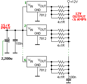

and for each voltage regulator there is a limit of 1A, so i cant regulate the voltage in series(12v, and then regulate again with 6V, and then regulate again with 5V, all in series) because all the currents add up will exceed the 1A limit at the first 12V regulator righ?

Postby zhenning » Sat Dec 08, 2012 1:51 am
To increase the current capacity, you can try adding the same regulators in parallel so that the currents are shared equally by the regulators.

Postby j6433 » Sun Dec 09, 2012 1:05 am
thanksss really helpful picture :D

Postby royalstorm7 » Thu Dec 13, 2012 11:36 pm
wow .. wadda complicated hardware for a simple problem ... i suggest u to use a single transistor as regulator that driven by voltage regulator ic ...far simple ... but it good to try more than 1 option ...
