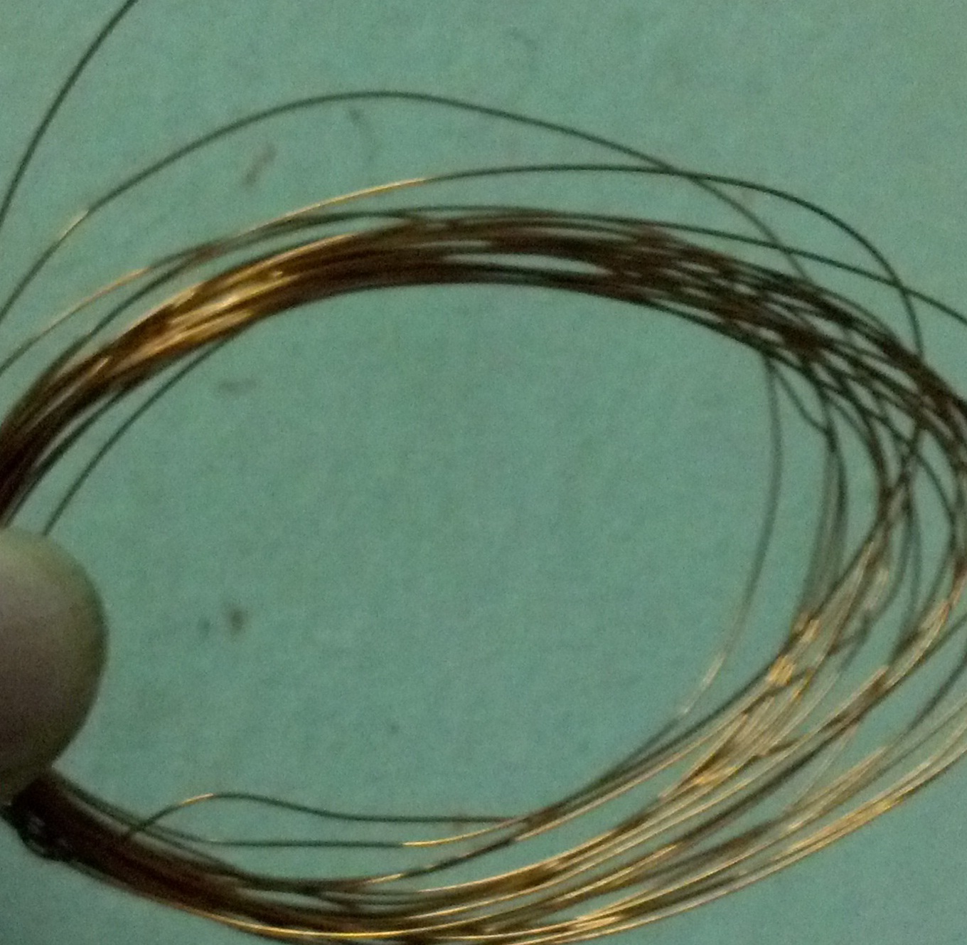

thank you for that opinion..yesterday i go to electrical shop to find the copper wire for the transformer,i ask for the swg 30..,but the guy in the shop said "i only sell,any detail im not sure,and not sure about swg or awg..,what i know the smallest size is 29" since only that shop sell the copper wire with the small size..so i bought it coz i also not sure..haha hope the picture i attached is right..coz its not a biggy if size 30 or 29 right?

Make sure that it is insulated. Measure it with an ohmmeter X1 scale that it doesnt conduct when touches probes on the skin of the wire.
Looks Ok but you have to wind it carefully not to break the ferrite ring. After winding , scratch the ends with a knife or use sand-paper to remove the insulation before soldering.

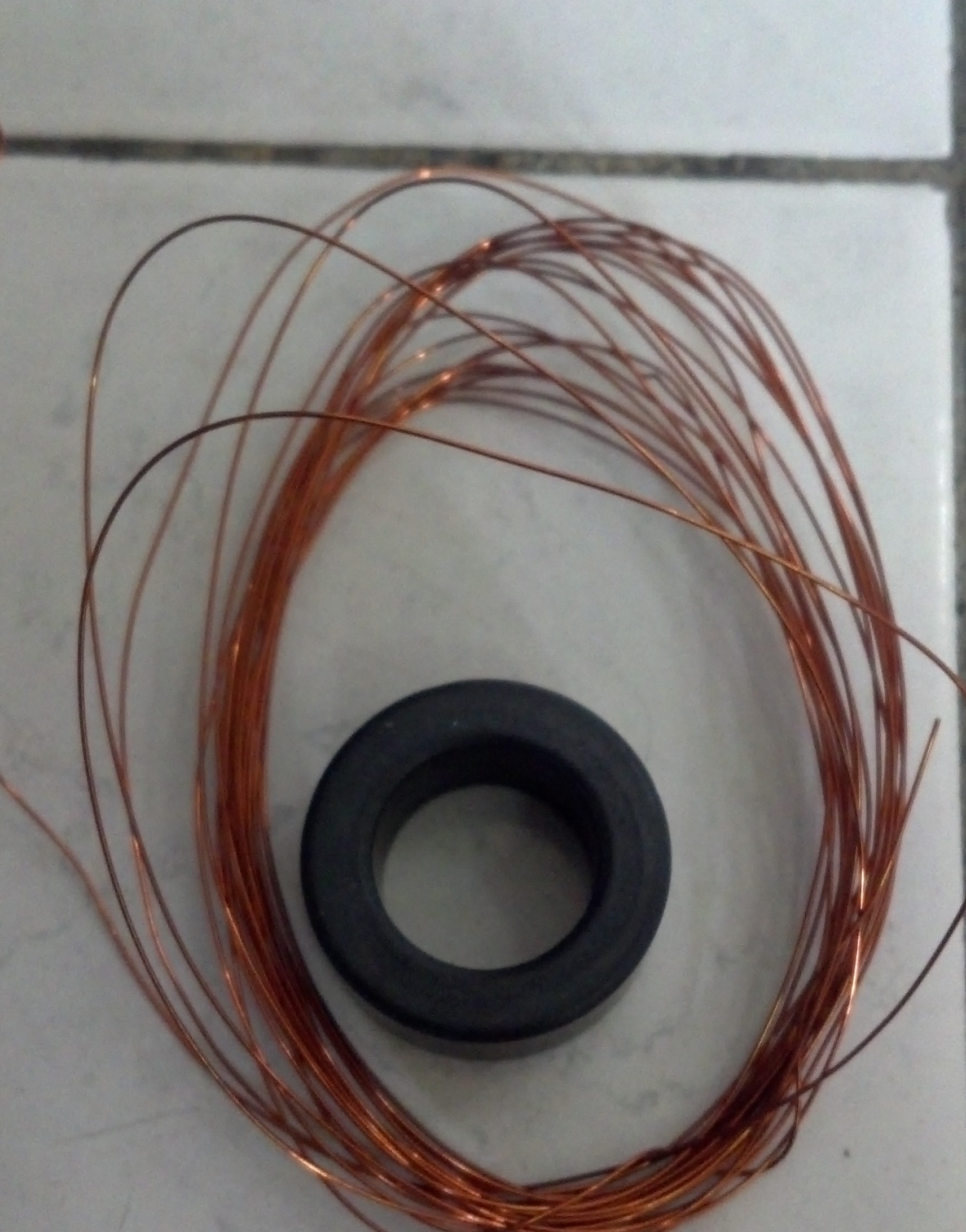

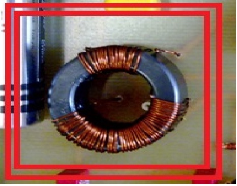

im a bit confused about this insulation you talking. the picture i attached, from my from 4eyes :shock: ,it look the same.., so i dont understand
ABSF WROTE:Make sure that it is insulated. Measure it with an ohmmeter X1 scale that it doesnt conduct when touches probes on the skin of the wire.
thank you and sorry
picture from previous project
ferric ring + copper wire
