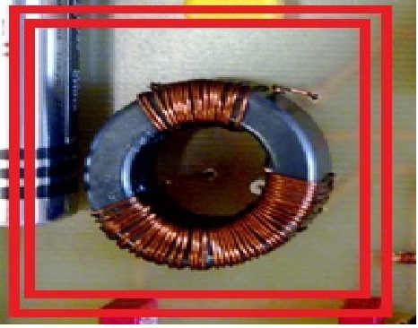

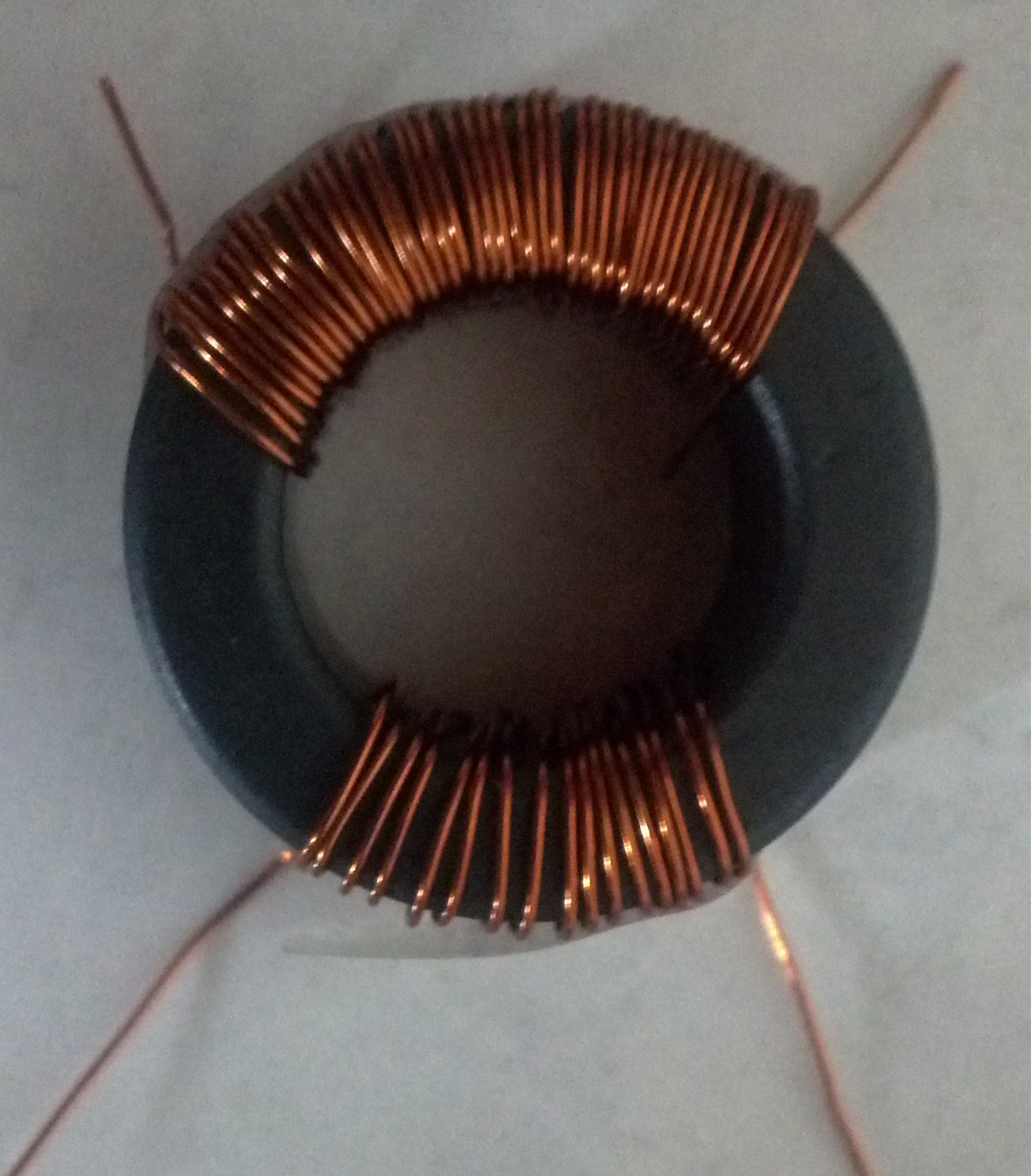

my first attempt to wind the wire to the ring...see the picture no1 that i attach..
the shape looks just like pic no2 but right now i only can keep it to the same shape closely coz i tape it using selefon tape,if got no tape,the it would not be that close if u get what i mean..so any idea / suggestion for this matter?
and next question is if what im doing is right,how to test it work or not?
thank you

tekiding WROTE:the shape looks just like pic no2 but right now i only can keep it to the same shape closely coz i tape it using selefon tape,if got no tape,the it would not be that close if u get what i mean..so any idea / suggestion for this matter?
Nice. 8-) You can make the coil rigid by applying selefon tape, hot glue or super glue. It's all up to you as long as the coil is not moving freely. To test it, just solder it to your circuit PCB.....How else can you test it?

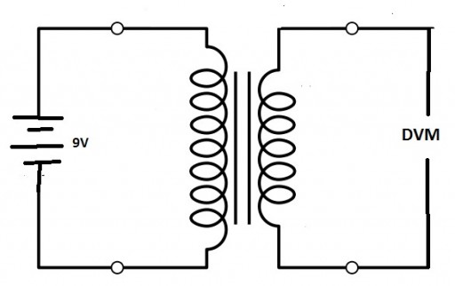

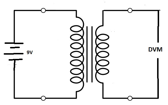

after scratch the end wif knife..,i try to apply what my frenz told me once how to check the transformer..,curiosity makes me wanna try it so i connect the primary(77t) to a 9v battery then connect mulimeter to the secondary(44t).nothing happen and turn out only drain the battery energy from 9v to 7v..
pic 1 is what i do..any comment about this?

Basically you need to change the current in the primary coil and that changes the magnetic flux produced. This magnetic flux which changes will induce voltage at the secondary coil. So....you need to apply AC, not DC.

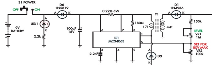

Postby tekiding » Thu May 24, 2012 10:45 am
thanks for repyling sich...
if i use this connection...will i able to use a dc source?

Yes, that's SMPS (switching mode power supply). Mind to tell us what's the ultimate goal you want to achieve? Boost up the input voltage?

tekiding WROTE:thanks for repyling sich...
Applying 9V to the circuit will cause mc23063 to generate AC from pin 1 for your ring transformer.
