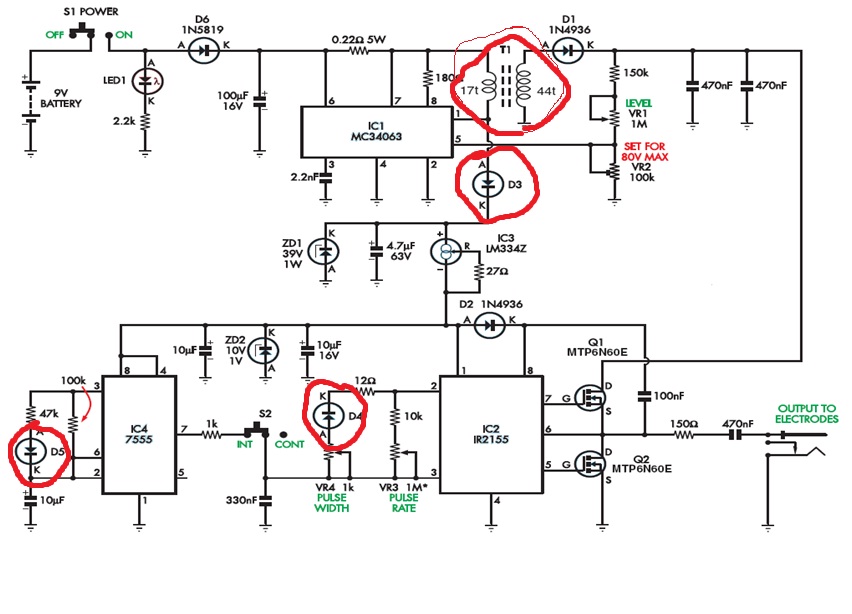

tekiding WROTE:i want to build a stimulator,but the schematic i got doesnt state the voltage for the transformer,only got 17t - 44t...and also the diode use also got no detail....anybody got a clues about that?really appriciate and thanks.

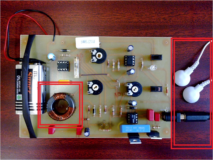

tekiding WROTE:yes,u r right.., thank you for replying...,but how to wind the transformer? using what? is it using a magnet and wire..,just make 17turn to 44turn just like in the pic i attached? hurm,any idea where to get the electrodes or something similar like that?
also in the circuit diagram pic,how about the diode that i circle? how to determine or identify the diode use..

just to confirm...17t mean 17turn right?
this ferric ring can be bought at jalan pasar right?
how about the output a.k.a the anode cathode electrodes...any ideas or clues or suggestion?

ferric ring is round magnet right?just like this http://www.weiku.com/products/3123215/ring_magnet.html
and about the wire,i google it then found this page http://www.whimsie.com/gauge%20wire.html so how to choose from gauge 2 until 36 for the 17t(thicker wire) and 44t(thinner wire)?

ABSF WROTE:The copper wires used in this project is commonly called as SWG wires or transformer wires in electrical shop. The bigger the SWG number the smaller the diameter the wire. For your project, I think the wire is about SWG 30. Here we normally use British terms. SWG=standard wire gauge and AWG=American wire gauge.
