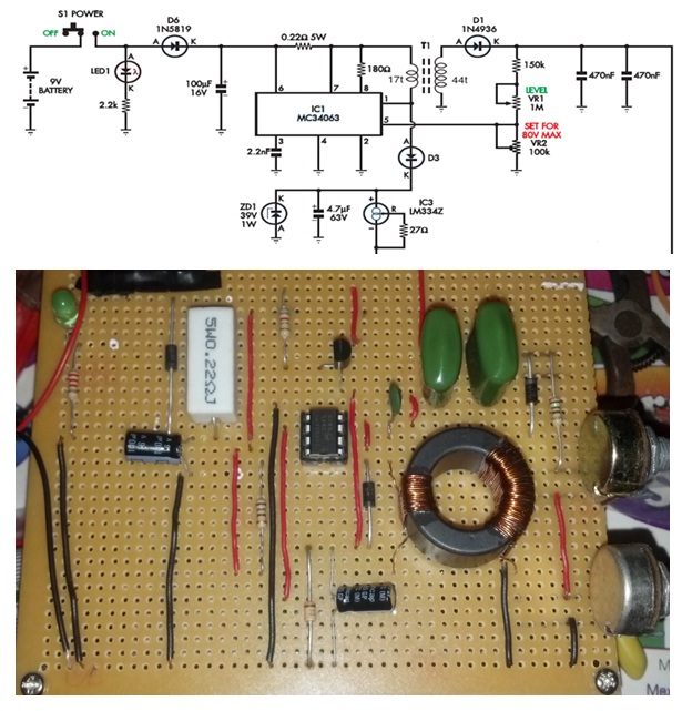

i already halfway to making this device(hopefully it works)...,but still about the transformer...,should i assemble the full circuit to test the transformer or can i test it like the picture i attached previously...only half of the circuit...,
Yes, you can test your circuit with the partial circuit you attached OR you can also test it using a simple 555 timer circuit. The timer should be in astable mode generating about 10KHz of square wave driving a small NPN transistor like BC547 or 2SC1518. The 17T coil connected to the collector through a 500 ohm resistor to +9V. You should get some AC voltage on the 44T coil.

this is what ive done so far...the prob is when i turn on the switch..i use DVM on the transformer primary,i use the ac mode i got reading +- 1.7 V to 2.6V (using ac) then i try dc mode i got +- 0.17V to 0235V (using dc) but nothing happen on the secondary.... T..T

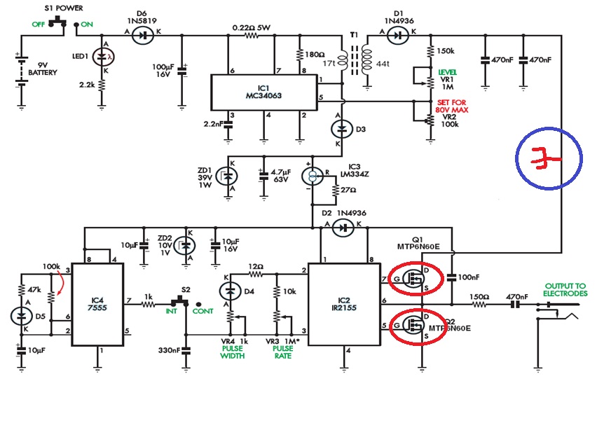

i buy the TENS unit from lelong and modify the stickypad
im using a 9V battery btw can i change the battery to adjustable adaptor?
b4 i could check at pin8(7555) and pin6(IR2153)..,something happen(which i got no clue)..maybe a random error.. :lol: kidding on the random error but right now i got no output at the electrode...,i troubleshoot,recheck the soldering i made but got nothing..the i use led to check voltage when accidently i short cct the connection(at blue circle) to ground and there's output at the electrodes but then i need to tap again and again from this point(blue circle) to ground to get the output at the electrode...so right now im clueless :?:
is it maybe the MTP6N60C(in red circle) that i use instead using MTP6N60E.but the connection is right and the datasheet for this 2 almost the same
MTP6N60E = #6.0A #600V #Rds=1.2ohm
MTP6N60C = #5.5A #600V #Rds=2.0ohm
