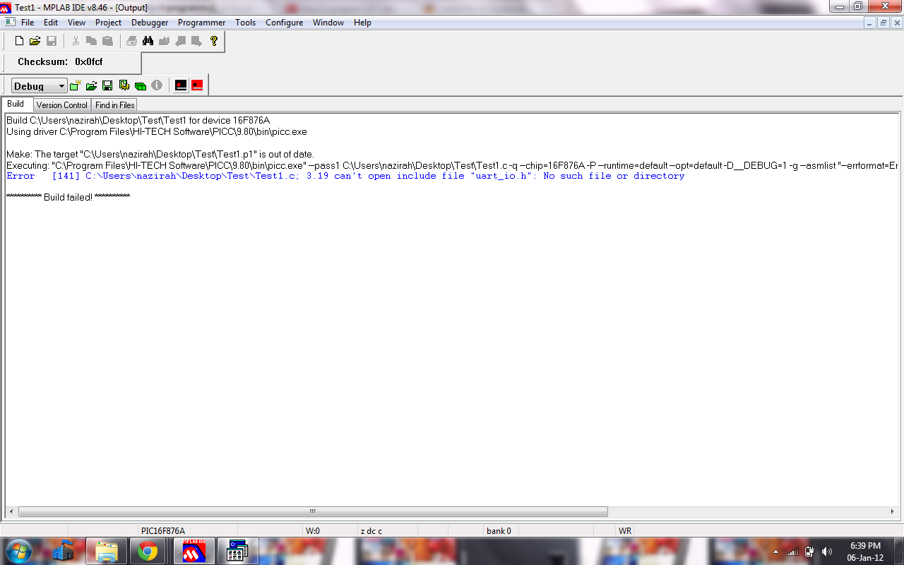

Postby Suria » Fri Jan 06, 2012 6:41 pm
i keep on getting that one.. what does that mean? :'(
Suria
Posts: 24
Joined: Sat Dec 31, 2011 11:21 am
Re: Combining PR29 and PR25
Postby robosang » Sun Jan 08, 2012 9:05 pm
I think you have the same problem as the other user, you din include the necessary c files and header files under the project window.
If possible, do printscreen the project window and share it here.
