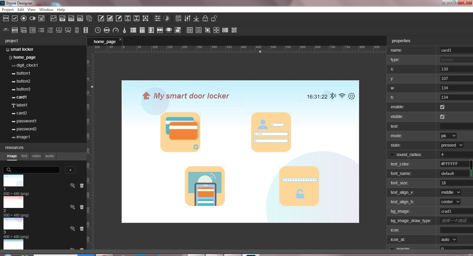

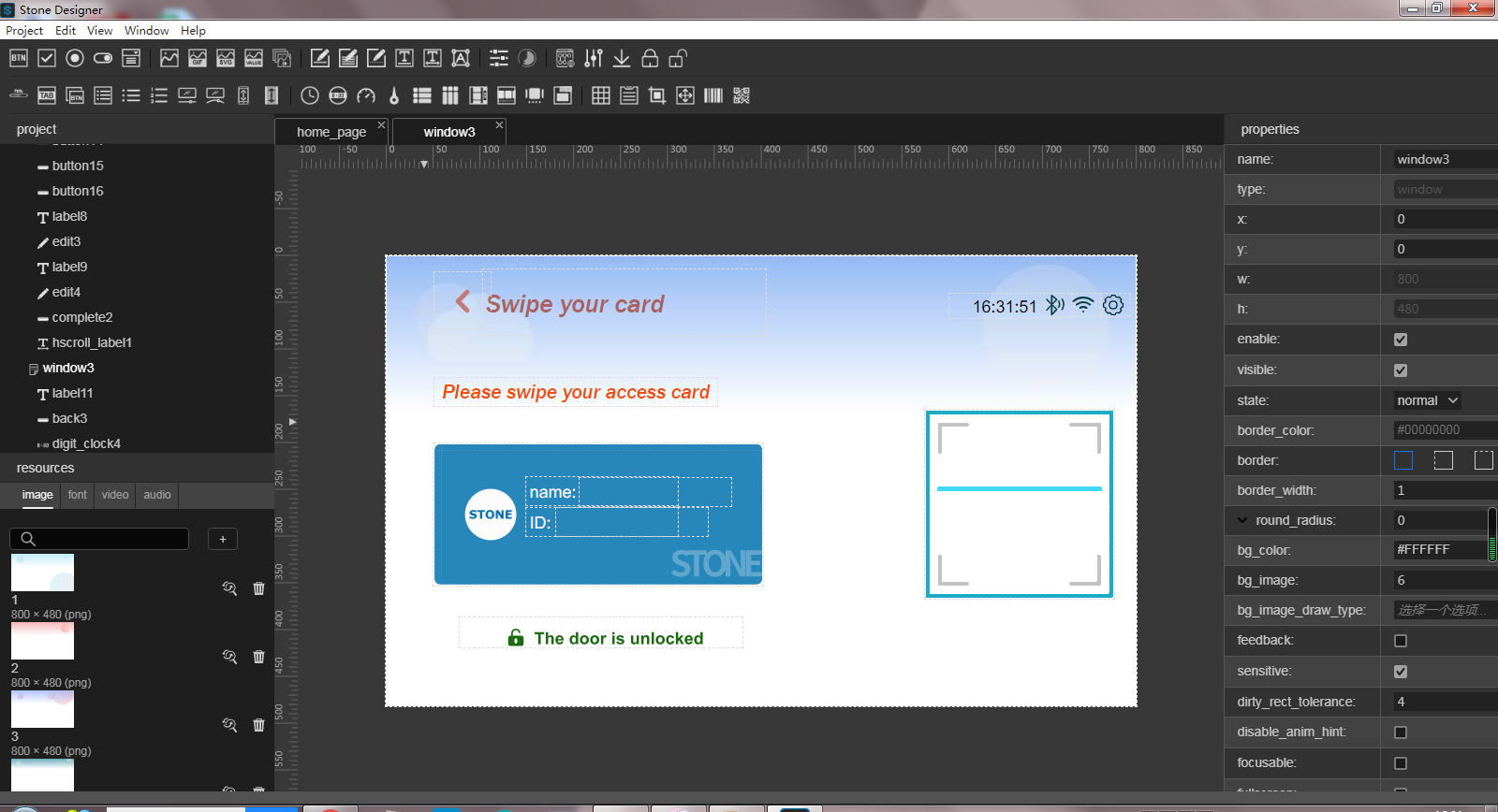

Postby Mars » Wed Aug 11, 2021 4:37 pm
I designed several interfaces through the GUI software that comes with the display. The functions I designed for now are card and password registration, as well as swiping the card and entering the password to unlock it.

Postby Mars » Wed Aug 25, 2021 4:59 pm
Hey, I'm updating again.
Realized function
1. card registration.
2. username and password registration.
3. card swipe to unlock the electronic lock.
4. User name and password to unlock the electronic lock.
Connection diagram
GUI design
part of code sharing

            data_id_st4 = ''.join(data_id_st3)
            print(data_id_st4)
            if data_id_st4 in personnel_ps:
               user_id_flag = True
               temp_id2 = data_id_st4
         elif data_id_st2 == 'edit6':
            data_id_st5 = rx2[15:data_end:1]
            data_id_st6 = ''.join(data_id_st5)
            print(data_id_st6)
            print(temp_id2)
            print(personnel_ps)
            if personnel_ps.get(temp_id2) == data_id_st6:
               password_flag = True
#         print(rx2,user_id_flag,password_flag)
               print(user_id_flag,password_flag)
               if (password_flag == True) and (user_id_flag == True):
                  uart_write(temp_id2,temp_id2)
                  password_flag = False
                  user_id_flag = False
                  suos.value(1)
                  uart2.write('ST<{"cmd_code":"set_visible","type":"widget","widget":"lock2","visible":true}>ET')
                  uart2.write('ST<{"cmd_code":"set_text","type":"label","widget":"edit5","text":"''"}>ET')
                  uart2.write('ST<{"cmd_code":"set_text","type":"label","widget":"edit6","text":"''"}>ET')
                  time.sleep(3)
#                  uart_write('student','')
                  suos.value(0)
                  uart2.write('ST<{"cmd_code":"set_visible","type":"widget","widget":"lock2","visible":false}>ET')
                  uart2.sendbreak()
while True:
   if uart2.any()>1:
      rx2 = []
      data_name2 = ''
      bin_data = uart2.read(40)
#      time.sleep(1)
      uart2.sendbreak()
#      time.sleep(1)
      rx1 = list(bin_data)
      for item in rx1:
         rx2.append(chr(item))
      print(rx2)
      if rx1[3:5:1] == button_cmd:
         data_name_len = rx1[6] - 1
         data_name = rx2[7:data_name_len+7:1]
         data_name2 = ''.join(data_name)
         print(data_name2)
         if data_name2 == 'card1':
            card_zhuce()
         elif data_name2 == 'password1':
            mima_zuce()
         elif data_name2 == 'card2':
            do_read()
         elif data_name2 == 'password2':
            password_loin()
