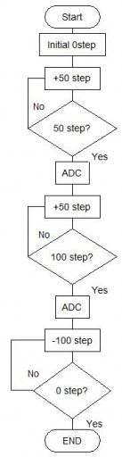

Postby wjwong » Sat Nov 05, 2011 5:03 pm
Any example of programming stepper?
90 degree = 50 step
+50step =100step
-100step =0degree

#define sw1         RD1
#define Relay      RB1
#define led_error1   RB2
#define led_error2   RB3
#define led1      RC1
#define led2      RC2
#define led3      RC3
#define led4      RC4
//   function prototype
void delay(unsigned long data);
//   global variable
//   main function
void main(void)
   //assign variable
   unsigned char A,B,C               //declare a temporary variable for reading ADC
   //unsigned char mode;               //declare a variable to represent current mode
   //set I/O input output
   TRISA=0b11111111;               //Ensure port A bits input
   TRISC=0b00000000;               //Ensure port C bits output
   TRISD=0b11111111;               //Ensure port D bits input
   TRISB=0b00000000;               //Ensure port B bits output
   //configure ADC
   ADCON0=0b10000001;               //enable ADC converter module
   ADCON1=0b10000100;               //configure ADC and ANx pin//configure ADC
   //initial condition
   led1=0;
   led2=0;
   led3=0;
   led4=0;
while(1)                     //infinity loop
      if(sw1==0)                //if SW1 OFF
         if(PORTC==0b00000000)         //Stepper at 0degree
            PORTC=0b00000000      //Stepper return 0degree
         else if(PORTC==0b00000101)      //Stepper at 90degree
            B=00000101;         //Stepper return 0degree
            PORTC=PORTC&B;
         else if(PORTC==0b00001001)      //Stepper at 180degree
            C=00000011;
            D=PORTC^C;
            PORTC=~D;         //1001^0011 then =~(0101)
            if(PORTC=00000101)
               PORTC=TRISC&B;
      else if(sw1==1)               //SW1 ON
//i have no idea on minebea stepper motor full stepping sequence "I just temporarily follow theory and waiting stepper motor to try" This is my first times on PIC in C hopes i doing right~~

Table Three. The normal sequence.
Step Q4 Q3 Q2 Q1
1 0 1 0 1
2 1 0 0 1
3 1 0 1 0
4 0 1 1 0
If sequence confirm is better to use shifting on C?

wjwong WROTE:Table Three. The normal sequence.
Step Q4 Q3 Q2 Q1
1 0 1 0 1
2 1 0 0 1
3 1 0 1 0
4 0 1 1 0
You need to try before you ask question, that's call learning. So how are you going to shift the above sequence in C?
