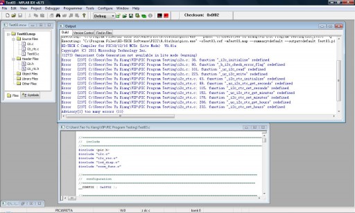

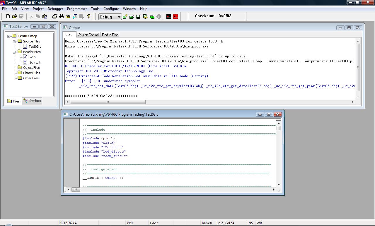

OK, when you include in your main C file, you should be writting:
#include "i2c.h"
#include "i2c_rtc.h"
NOT the i2c.c file.

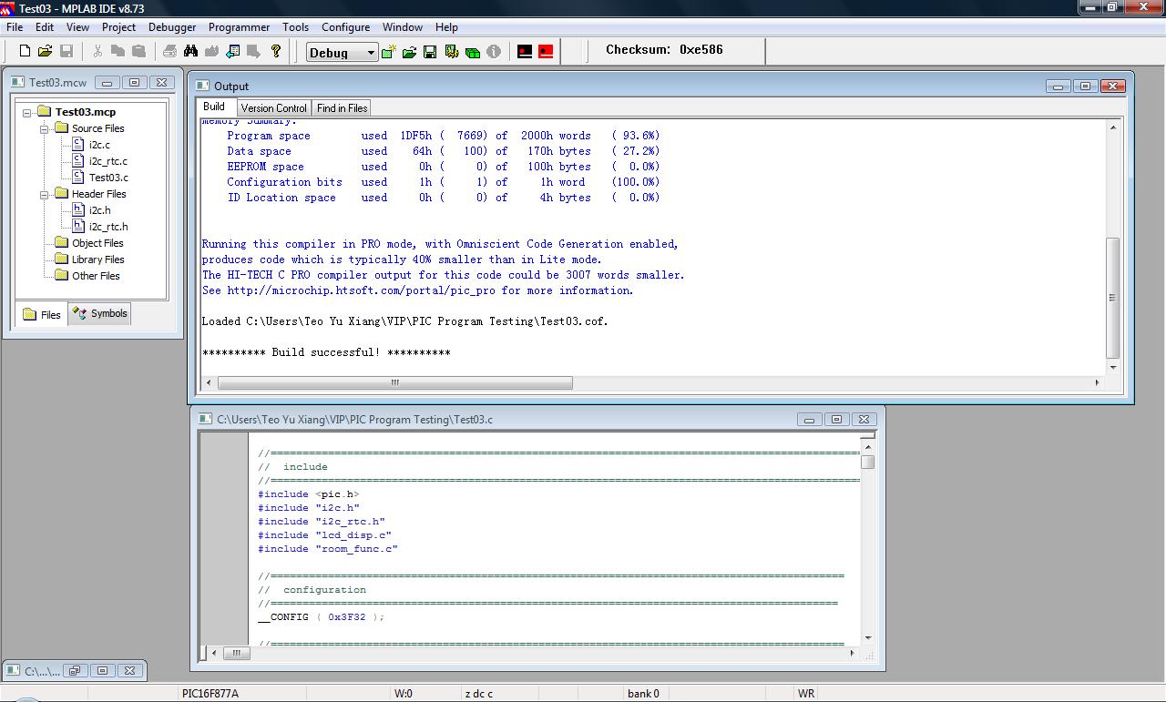

What I worry is you din not include the necessary files under project window. Project window is small window at the right top corner of MPLAB IDE which show what is the files (.c) being included under Source Files, and .h files under Header Files. Print screen and show it to us.
