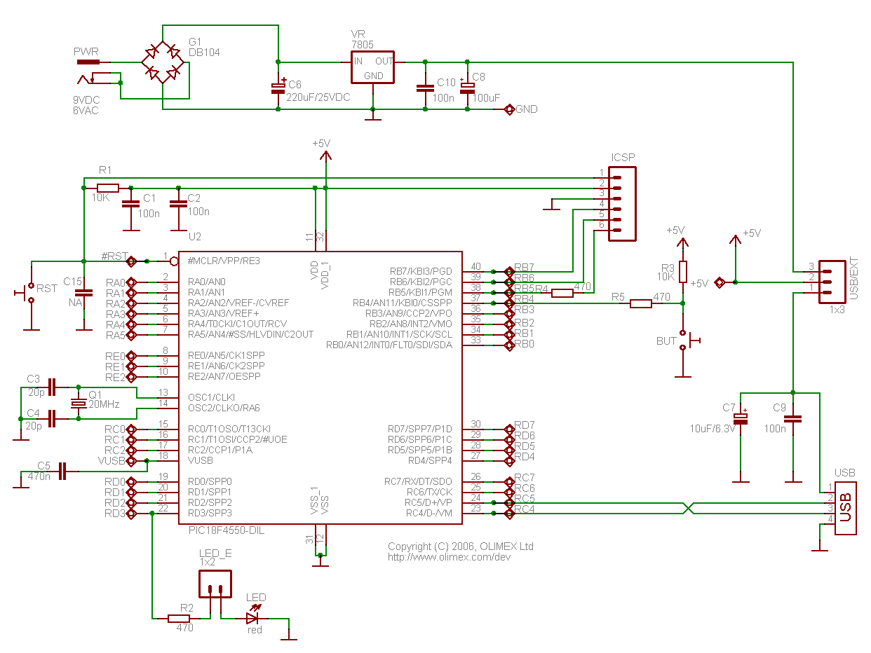

I am building a circuit using PIC 4550 and i follow the circuit provided by olimax. But when i connect it with PICKIT 3 this error come out "Target Device ID (00000000) does not match expected Device ID (00001200)." The attachment is the circuit that i'm using.
This is the circuit that i'm using

have u checked ur soldering?

A clear photo of the hardware might be helpful 8-)

Its ok now.. I found the problem my self... there were some short circuit
