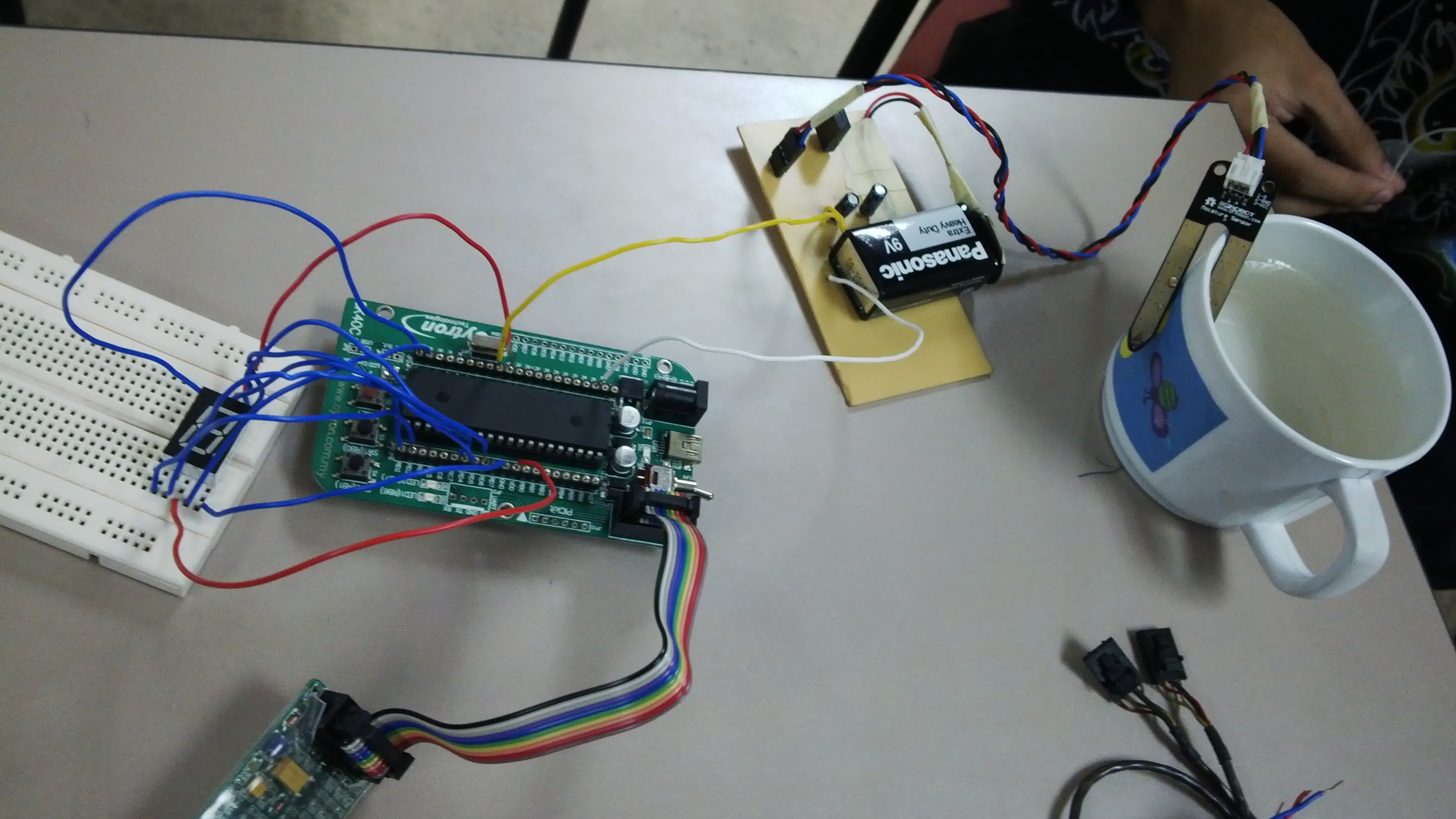

Hello everyone,
Below is the picture of my circuit connection. Humidity sensor is connected to pin RA0 (analog input) and all pin PORTD connected to 7 segment display (common anode) as output. What I want to do is to display ONLY the content of ADRESL registers to 7 segment display.
Note:
white wire=output from sensor connected to pin RA0
yellow wire=ground from sensor connected to ground to PIC
blue wire=output from PIC of PORTD pins (RD0-RD7)
red wire=Vdd (5V) from PIC to 7segment display
The problem is I write this code:

Anything goes wrong? I am not sure the setting for ADCON0 and ADCON1. I am also not sure about the code I highlight in red colour above. Are they all correct?
circuit connection

Postby shahrul » Fri Sep 13, 2013 9:51 am
If you read adc on RA0, TRISA0 should set to 1 to become an input.
Then, I'm not checking the remaining code.

Postby sich » Tue Sep 17, 2013 6:29 pm
Actually what's the problem you encounter? And what have you achieved so far? What's the output of code? Please be more specific so we can assist you more effectively.
