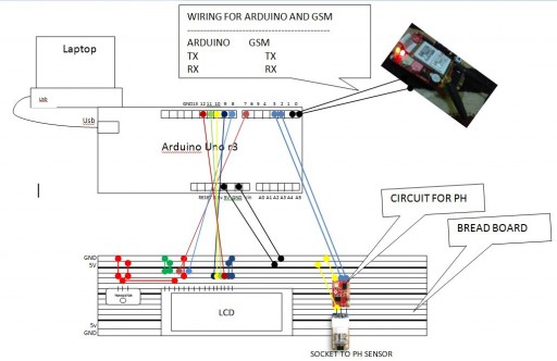

now i need to develop the project... before this my proposal i write that im using LCD 16x2 not the LCD keypad shield.. can u see what the problem in my wiring? :oops:

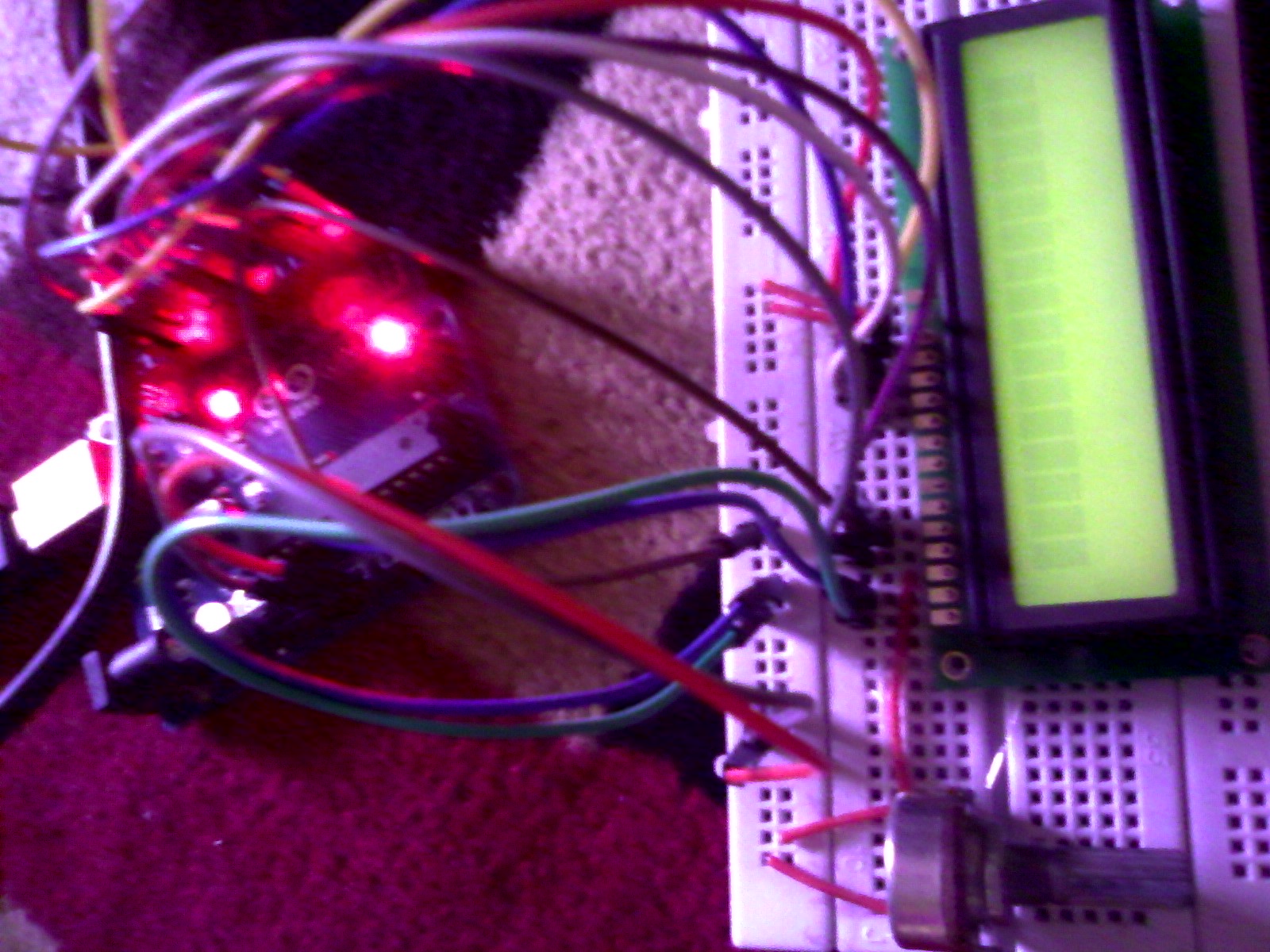

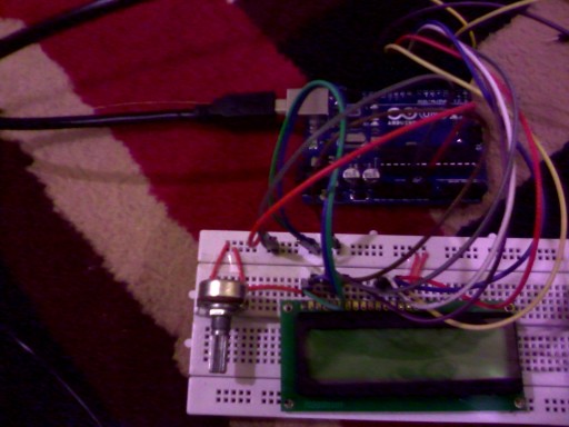

I don really understand why you don want to share the photo with the power is ON and the program is loaded. This will help us to see how is the LCD output and then help you. Do what you can, and we will do what we can.

sorry sir.... i really want to upload the picture but the quality of my picture is not really good.
here some picture i capture.
1) first picture is not have power because the red led is so light.
2) the power had put on and the coding is burn
3) is the picture that i had draw using word, the wiring that i used.. what wrong with the wiring? because the lcd is not display any word.

The connection seem to be correct with the sketch.
Is the header pin on LCD being soldered properly? Because I cannot really see any lead on the pad of LCD.

Postby Hidayah » Mon Nov 11, 2013 10:01 pm
i not sholder the lcd pin... i just put the pin in the hold of lcd..
did is effect of the output?

Postby robosang » Mon Nov 11, 2013 10:46 pm
Great! Superb work.... I have nothing to say about this. :o
Re: LCD and Arduino board
Postby Hidayah » Sun Nov 17, 2013 12:19 am
i had solder the lcd... and u know.... it work..... :cry:
i spend alot of time to display the word in lcd,
because i not solder the pin, it not work.. after i solder it... it is work.... :oops:
