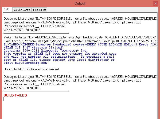

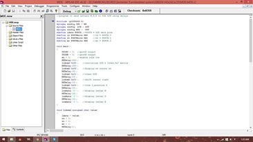

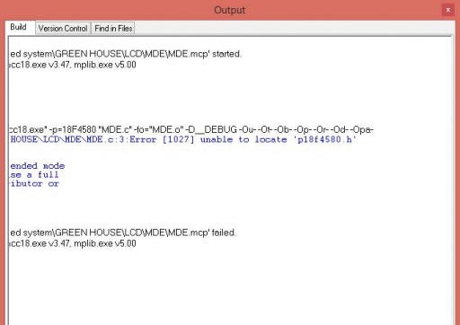

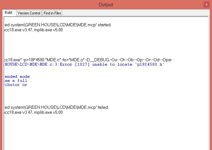

i use the mplab to build my pic18f4580 project but it can't... it show that the library of p18f4580.h is not found

which compiler?
#include <p18cxxx.h> for c18
#include <xc.h> for xc compiler
#include <htc.h> for hitechc
Re: mplab cannot build
Postby mcgyver » Sun Dec 06, 2015 12:55 pm
haha... i just found the solution... need to add back all library file in the seting
