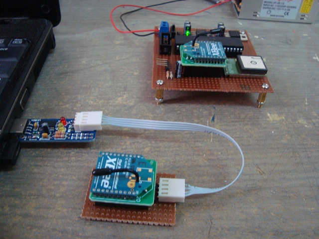

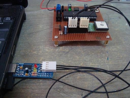

Postby shahrul » Sat Mar 17, 2012 9:19 am
Here the photo
Method 1, connect GPS >> USB-to-UART
Method 2, connect GPS >> XBee ----- XBee >> USB-to-UART
The result on VB
GPS Data.jpg (55.31 KiB) Viewed 6464 times
The transistor circuit is below the XBee
The bottom of this, I simply use jumper to connect what I want
GPS TX >> PIC RX, PIC TX >> XBee or GPS TX >> Transistor >> PIC RX, PIC TX >> XBee
These 2 can't function.

Re: Connect LVTTL to PIC
Postby robosang » Sat Mar 17, 2012 10:32 am
Hey, shahrul, very nice photo! Super clear!
Seem to me the hardware is correct :) and tidy!
