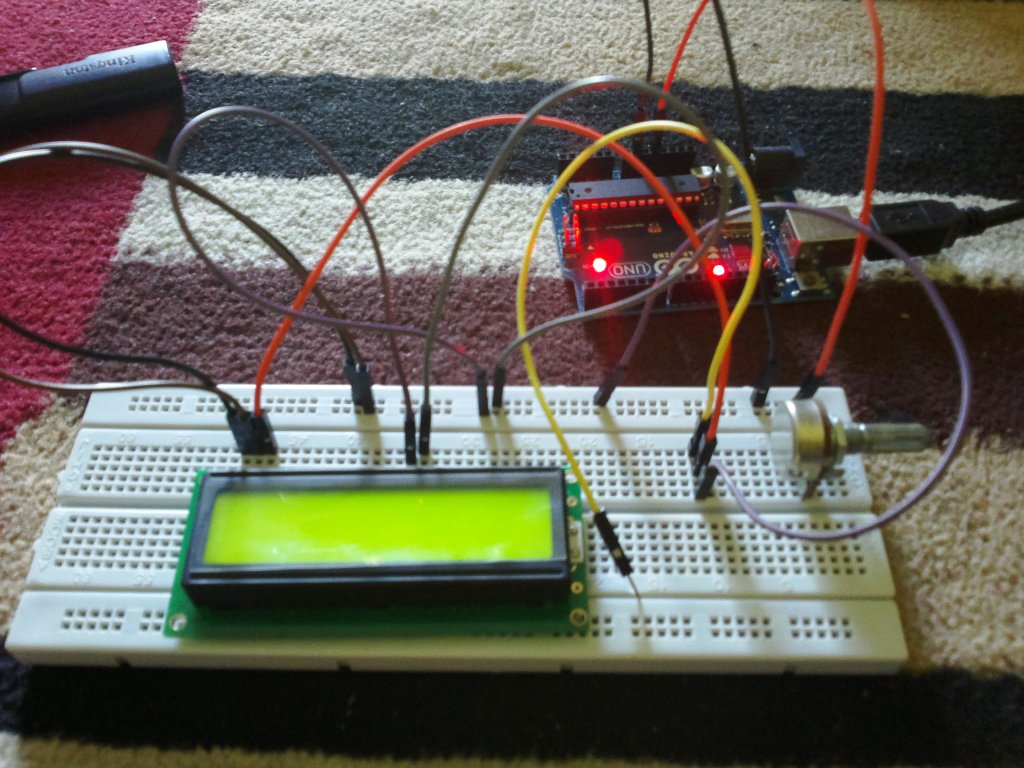

Postby Hidayah » Tue Oct 22, 2013 1:24 pm
can u see what is wrong?
if i put the yellow jumper to the - bread board, the lcd and arduino will not on.. if i not put the yellow jumper it will turn on.
for easy to u, the yellow wayer is left side of transistor.
can u help me..

Postby robosang » Tue Oct 22, 2013 9:32 pm
What do you mean by putting the yellow wire to breadboard? Which hole you are talking about? Please make yourself clear and do not confuse us. BTW, where is the transistor?

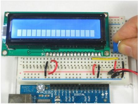

Re: LCD and Arduino board
Postby Hidayah » Wed Oct 23, 2013 11:40 am
Sorry because of that picture... i just follow circuit like this picture...
my LCD is on but the lcd not display like picture, that lcd have line in the lcd.

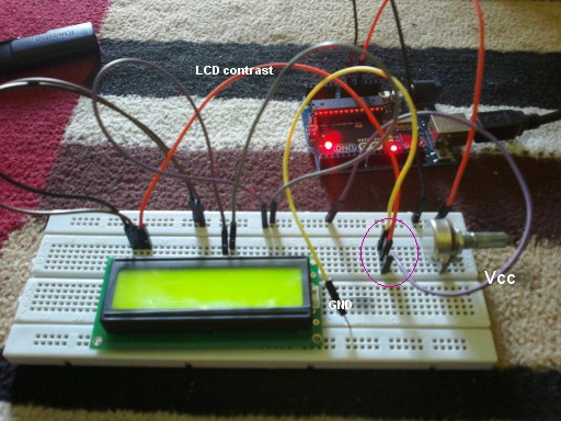

Postby ABSF » Wed Oct 23, 2013 8:08 pm
The way you connect the variable resistor (pot) is wrong. The 3 wires to the pot are all in same row of connecting holes so the Vcc, Gnd and LCD contrast pins are all shorted together. That's why you have to remove the yellow wire which is ground so the the Vcc and Gnd are not shorted.

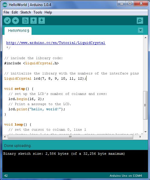

Postby Hidayah » Thu Oct 24, 2013 5:11 pm
thanks alot sir.... my LCD have display the black blok...
my breadboard also have wrong... some hole is not function.
i try upload the simple code into arduino uno board.. but noting happen...
this is my code that copy from arduino example,
i just adjust of "LiquidCrystal lcd(7, 8, 9, 10, 11, 12)" because i connect LCD to arduino board using different pin like i attach :
// include the library code:
#include <LiquidCrystal.h>
// initialize the library with the numbers of the interface pins
LiquidCrystal lcd(7, 8, 9, 10, 11, 12);
// set up the LCD's number of columns and rows:
lcd.begin(16, 2);
// Print a message to the LCD.
lcd.print("hello..");
// set the cursor to column 0, line 1
// (note: line 1 is the second row, since counting begins with 0):
lcd.setCursor(0, 1);
// print the number of seconds since reset:
lcd.print(millis()/1000);

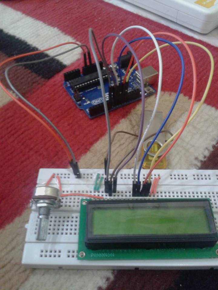

Postby Hidayah » Sat Oct 26, 2013 10:35 am
this is my wiring for LCD and arduino board.
the lcd had on and had line black box appear in LCD.
but after i upload the coding into arduino... nothing happen.... can u see what the problems?
thanks....
