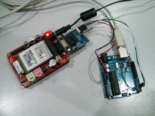

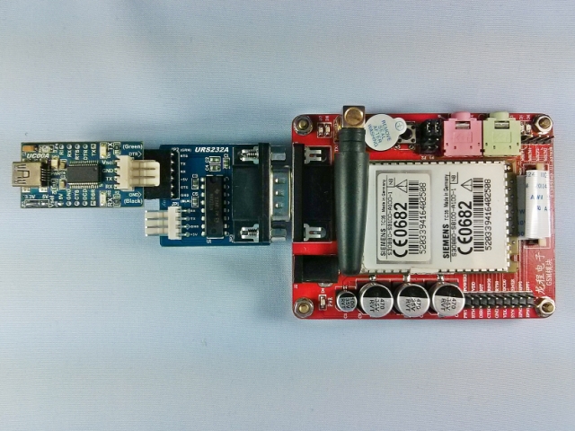

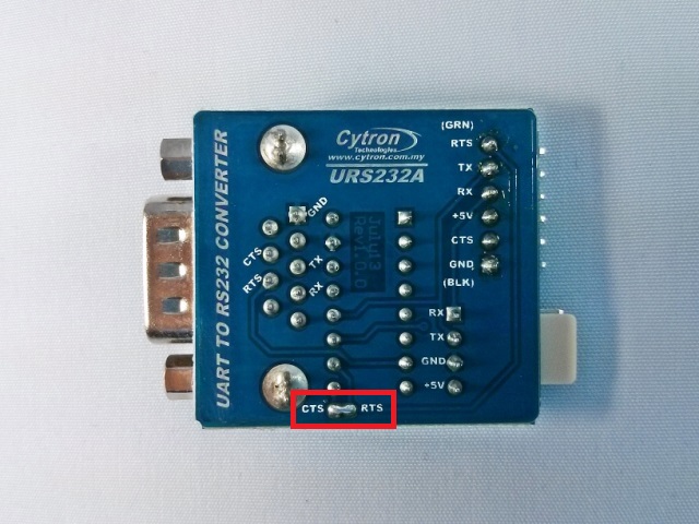

I already test the GSM TC35 using URS232A connect to PC and Arduino. This is the step:
1. Short RTS and CTS on the URS232A
2. Connect URS232A to UC00A (use 6 header pin) for USB on the PC connection. Open HyperTerminal software. Test AT command.
3. Connect URS232A to Arduino pin (URS232A TX - D2, URS232A RX - D3).
4. Open "Examples - GSM - Tools - TestModem". Result example:
