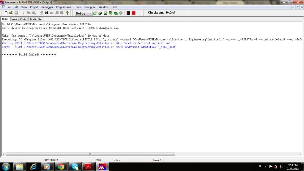

You need to check what causes the build to fail. Look into the Output panel. There may have some diferences between the two microcontroller. Perhaps different Configuration bits, registers naming...anyhow do refer to the datasheet all the time. You can't program a chip without reading it's datasheet.

ABSF WROTE:I saw that you've modified your own codes. Is it working now? Still Build Failed?
Ya..build successful now :)
Afternoon I still can get build successful.But now I try build it/debugg it, this is the error msg I get :(
Help @@@

Are you still referring to the pr_11 tutorial program?
_XTAL_FREQ is defined in "system.h". Did you #include the "system.h" in your program?

Ya...but the code I write it myself do not have the system.h header...Cause I thought the system.h is another library built by the cytron's programmer itself to include all the things ?..Mine build failed

You need to include "system.h". The comment told us to do so...
void delay_ms(unsigned int ui_value)
   while (ui_value-- > 0) {
      __delay_ms(1);      // macro from HI-TECH compiler which will generate 1ms delay base on value of _XTAL_FREQ in system.h
