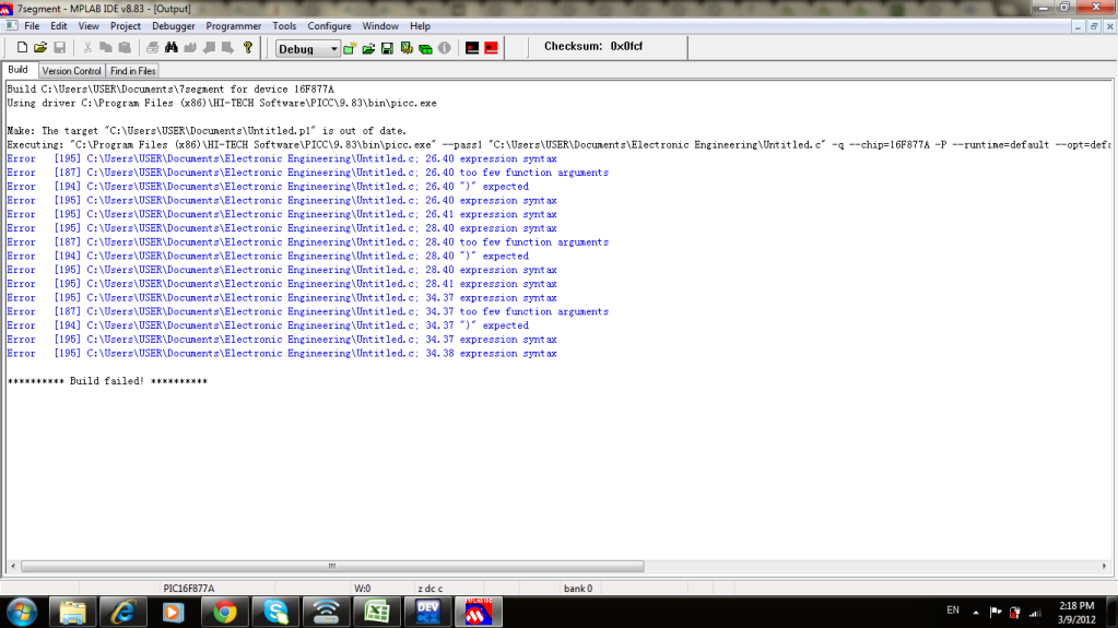

#include <htc.h>
__CONFIG(0x3F32);
#define _XTAL_FREQ 20000000;
void delay_ms(unsigned int ui_value);
void main(void)
   PORTA=0;
   PORTB = 0;
   PORTC = 0;
   PORTD = 0;
   PORTE = 0;
   TRISA = 0x00;
   TRISB = 0x00;
   TRISC = 0x00;
   PORTC =0b0011111;
   __delay_ms(2000);
   PORTC = 0b00000110;
   __delay_ms(2000);
   while (ui_value-- > 0) {
      __delay_ms(1);      // macro from HI-TECH compiler which will generate 1ms delay base on value of _XTAL_FREQ in system.h
This is my latest code and below is the error I get when compile it:
If I add system.h , this is another error that it will be :
So how ?
If I use this delay function it is ok.

Re: SK40C Beginner
Postby ABSF » Fri Mar 09, 2012 5:47 pm
Corrected code.
#include <htc.h>
__CONFIG(0x3F32);
void main(void)
PORTA=0;
PORTB = 0;
PORTC = 0;
PORTD = 0;
PORTE = 0;
TRISA = 0x00;
TRISB = 0x00;
TRISC = 0x00;
PORTC =0b0011111;
delay_ms(2000);
PORTC = 0b00000110;
delay_ms(2000);
__delay_ms(1);
