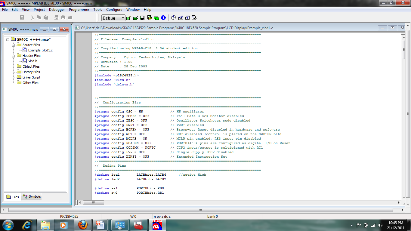

Postby yasotha padmanathan » Fri Dec 23, 2011 11:08 am

Postby ober » Sat Dec 24, 2011 1:18 pm
is there any xlcd.c file beside xlcd.h in the project folder? It seem you did not include the xlcd.c under Source Files folder in your project window.
Also check if there is any delays.c file, if there is, please include it under Source Files folder too. Try it again, might solve the problem, but not necessary that is the only problem 8-)
