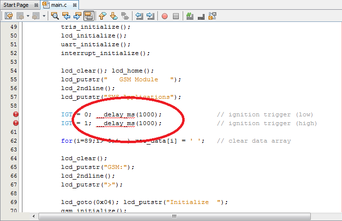

Postby redips_id » Thu Mar 08, 2012 11:13 pm
Hi Guys,
It says "Unable to resolve identifier __delay_ms". Anyone experience it? How to resolve?
I used the same program in MPLAB IDE 8.83 and there have no problem.

Postby redips_id » Thu Mar 15, 2012 9:55 am
I'm using MPLAB X IDE + Hi Tech C Compliler. It is only a warning, the compilation is successful. It is ok now after I define it.
#define delay_ms(x) __delay_ms(x)
However it is still a weird, it should be can be used directly without a warning.

i also see this in mplabx. sometime also other variables shows this warning. however it will compile successfully, so i dont care it yet. :D

I used the Mplab X IDE and it compiles all-OK despite the __delay_ms() being underlined.
You may need to put "#define _XTAL_FREQ ________" (the empty blank is frequency in hertz) at the start of the code, though.

Add this code on top of your program.
#ifndef _XTAL_FREQ
#define _XTAL_FREQ 20000000
#endif
#pragma inline(_delay)
extern void _delay(unsigned long);
#define __delay_us(x) _delay((unsigned long)((x)*(_XTAL_FREQ/4000000.0)))
#define __delay_ms(x) _delay((unsigned long)((x)*(_XTAL_FREQ/4000.0)))
It should work after this.
