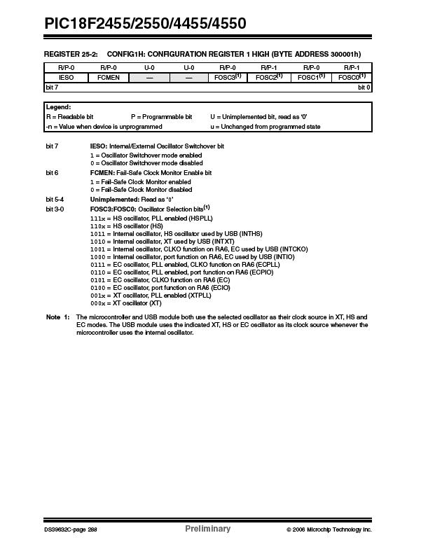

Postby ABSF » Sun Apr 15, 2012 10:57 am
FakeSheep WROTE:Yes, i already checked my hardware
But 1 thing is, i tried to set my OSCCON as B'01100010' which is internal OSC with 4Mhz
i cant able to set OSCCON as B'01100010', but only B'01100000'
bit 1-0 SCS1:SCS0: System Clock Select bits
1x = Internal oscillator
01 = Timer1 oscillator
00 = Primary oscillator
The primary oscillators include the External Crystal
and Resonator modes, the External Clock modes and
the internal oscillator block. The particular mode is
defined by the FOSC3:FOSC0 Configuration bits. The
details of these modes are covered earlier in this
chapter.
I am not familiar with the MPLAB simulator. But if it set the 1x internal oscillator to 00 Primary Oscillator. The control is passed to Configuration bits CONFIG1H......
CONFIG1H contents

Postby ABSF » Sun Apr 15, 2012 2:49 pm
What about this program?
;connect LED to PortD, Bit 1
#include P18F4550.INC
CONFIG WDT=OFF; disable watchdog timer
CONFIG MCLRE = ON; MCLEAR Pin on
CONFIG DEBUG = ON; Enable Debug Mode
CONFIG LVP = OFF; Low-Voltage programming disabled (necessary for debugging)
CONFIG FOSC = INTOSCIO_EC;Internal oscillator, port function on RA6
 org 0; start code at 0
 CBLOCK 0
Delay1:1
Delay2:1
 ENDC
 ORG 0
;Delay1 res 1 ;reserve 1 byte for the variable Delay1
;Delay2 res 1 ;reserve 1 byte for the variable Delay2
Start:
 CLRF PORTD
 CLRF TRISD
 CLRF Delay1
 CLRF Delay2
MainLoop:
 BTG PORTD,RD1 ;Toggle PORT D PIN 1 (20)
Delay:
 DECFSZ Delay1,1 ;Decrement Delay1 by 1, skip next instruction if Delay1 is 0
 GOTO Delay
 DECFSZ Delay2,1
 GOTO Delay
 GOTO MainLoop
