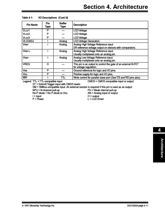

According to the registers above, I set RA3 as Vref+ and RA2 as analog input:
TRISA = 0b11111;
TRISE = 0b111;
ADCON0 = 0b10010001;
ADCON1 = 0b10000001;
__delay_ms(2);
   ADGO=1;
   while(ADGO==1)
      continue;
   return(256*ADRESH+ADRESL);
I can't get any power supply from RA3, why? If there is no power supply from RA3, then why LCD didn't show 0 value? Any problem with my register setting?

Vref+ is an input pin. You're not going to get any voltage from it.

The Vref+ of the ADC is selectable to Vdd internally or externally through RA3 by the "PCFGx" bits. The external Vref+ can be 0-5V using linear pot or a voltage reference chip such as TL431.

1st thing, PIC does not have analog output pin, only Analog Input pin. Of course some uses PWM output to get analog voltage, still you need to do some circuitry to get that :)
2nd, don know why you want to change the Vref(+) to RA3, just tie it to VDD which is 5V normally. For cases where Vref(+) is tie to I/O pin is they wanted the Vref(+) to be other than VDD, example 2.0V, 4.0V, 1.023V.....
