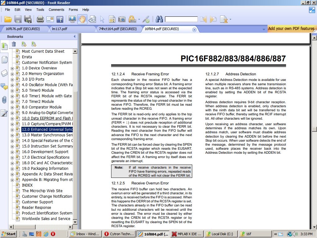

Postby takao21203 » Mon May 07, 2012 10:28 pm
It's kind of a multi-slave mode. I have not used it myself, only saw it in the manual.
Only some PICs support it.
You include the address, and only the selected slave responds.
See screenshot from the PDF.

Postby sich » Wed May 09, 2012 3:12 am
This addressable usart is actually using a bit (9-bit) to determine that the received byte is the address byte or data byte. Both master and slave(s) need to be set to the same mode and the address matching is done in user software.
