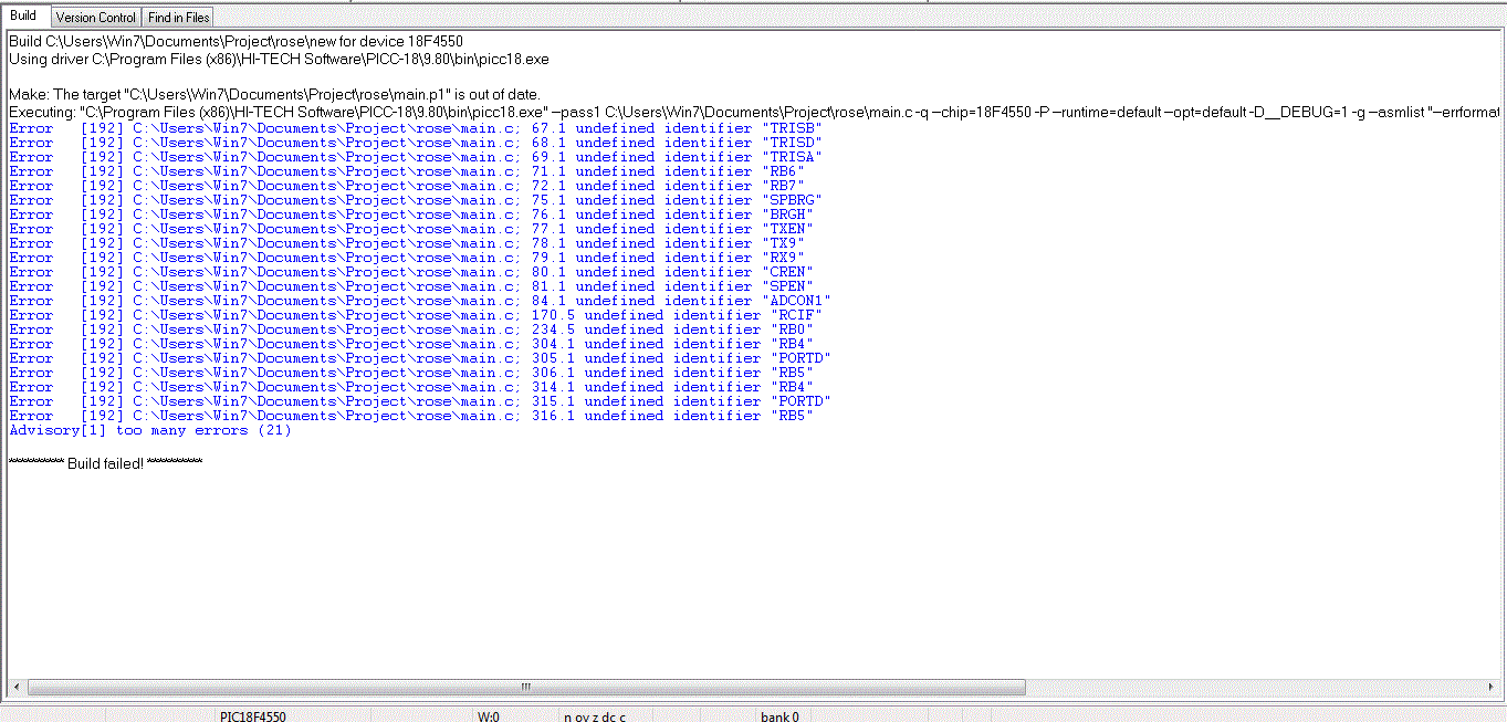

i already download the full source code for 'Control and Monitor via SMS' but i do not know how to change the phone no inside the source code.. can anybody help me? i already 2 type sofware, but both give out error. I try to build after change the phone no. but there is error as in pic

silver WROTE:hello..
thx for view.
What is the model of the PIC you use?

PIC18F4550 from cytron

The sample source code is written for PIC16F877A and it's not compatible with PIC18F. You will need to do some modification to the source code.

Thanks.. can you teach how to modify the source code.. I really do not know how to modify.

This depends on what C compiler are you using. The name of the SFR is different for different compiler.
The easiest way is to change your PIC to PIC16F877A and use High Tech C compiler. Then you can use the sample source code directly.
