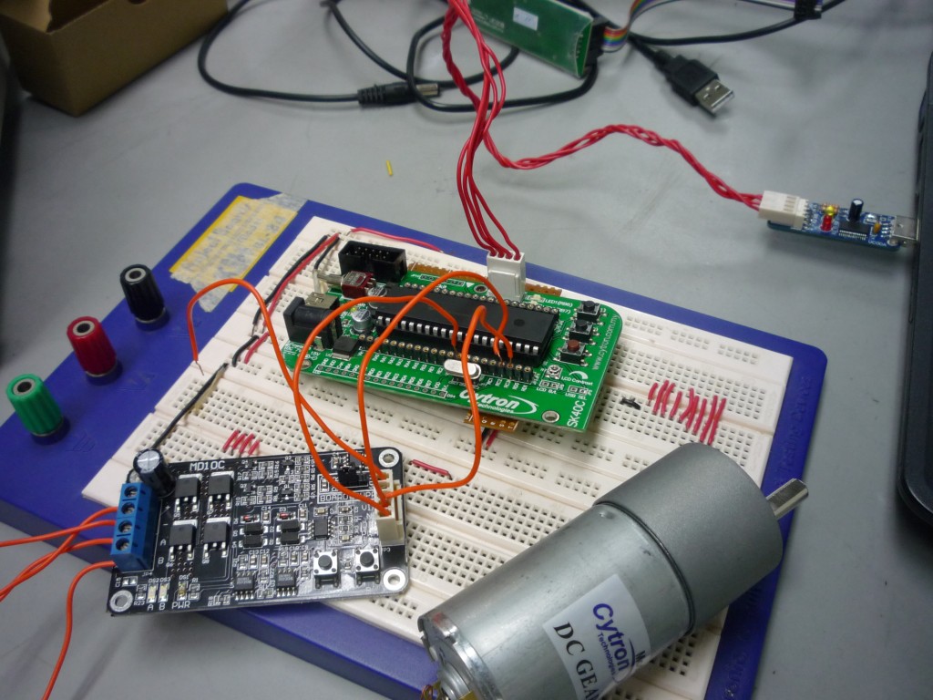

I'm working on a project which one of the requirement is to control 2 motors by using a Visual Basic application. I've tested both MD10Cs and the SPG50-180K motors that I have by performing the fast test, and all 4 components works perfectly.

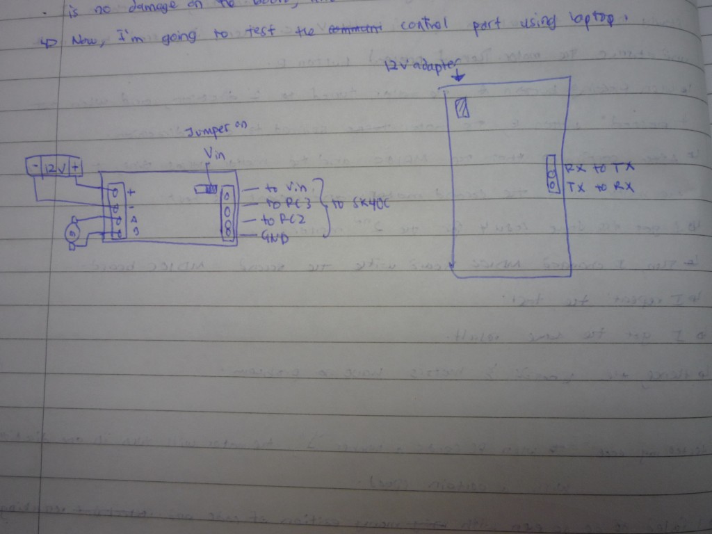

Then, I made a test of controlling one motor from SK40C only, whereby I connect 12V adapter to SK40C, set the jumper on MD10C to Vin, and connect the necessary connection. In the test, whenever I press SW1, the motor will turn in one direction, and when I press SW2, the motor will turn to another direction, and the test was succesful.
The third test was UART test, where by I connected SK40C alone to UC00A to my laptop. I made a dummy program whereby whenever I send a number from Hyper Terminal or my VB application (also I made a simple program for this test), the microcontroller will add 1 to the number send by my laptop and send it back to the Hyper Terminal/VB application. The test was also a success.
After all the tests mentioned, I know that there is no damage/spoil to my MD10Cs and SK40C and I also know that the UART communication works perfectly.
For now, I'm testing to control 1 motor from the Hyper Terminal. The program goes like this, whenever I send "1" from HT, the motor will turn in one direction, and when I send "2", the motor will turn in another direction. But so far, it doesn't work. I emailed Ober Choo by stating my problem and I attached the following pictures to him.**

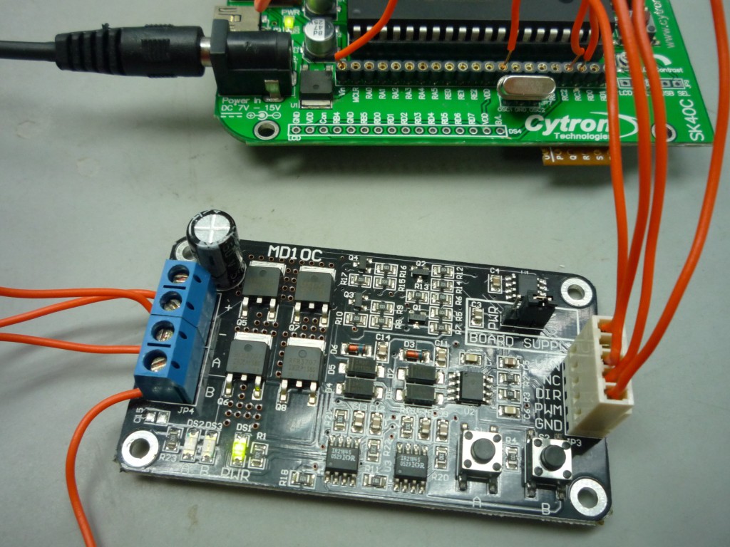

LHS is MD10C and RHS is SK40C
Circuits connection
Circuit Connection - Close up
He suggested that I connect the GND from UC00A to SK40C, and I did. So now, instead of only Tx and Rx, GND is also connected. VDD on UART is left alone. But after I did so, I found out that SK40C is now powered by UC00A. To make sure I was right, I unplugged the 12V adapter, and test the dummy program I mentioned earlier, and it works! Which is weird because I dont connect VDD and I didnt supply any power. Can anyone please explain why SK40C is powered when GND is connected?

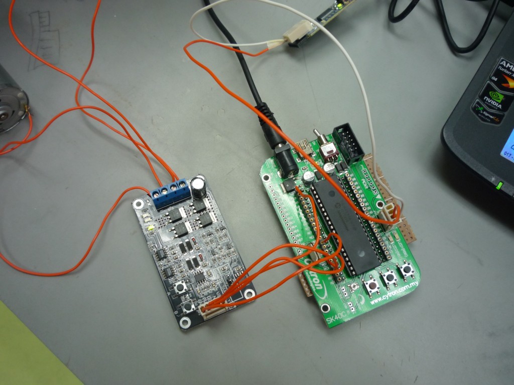

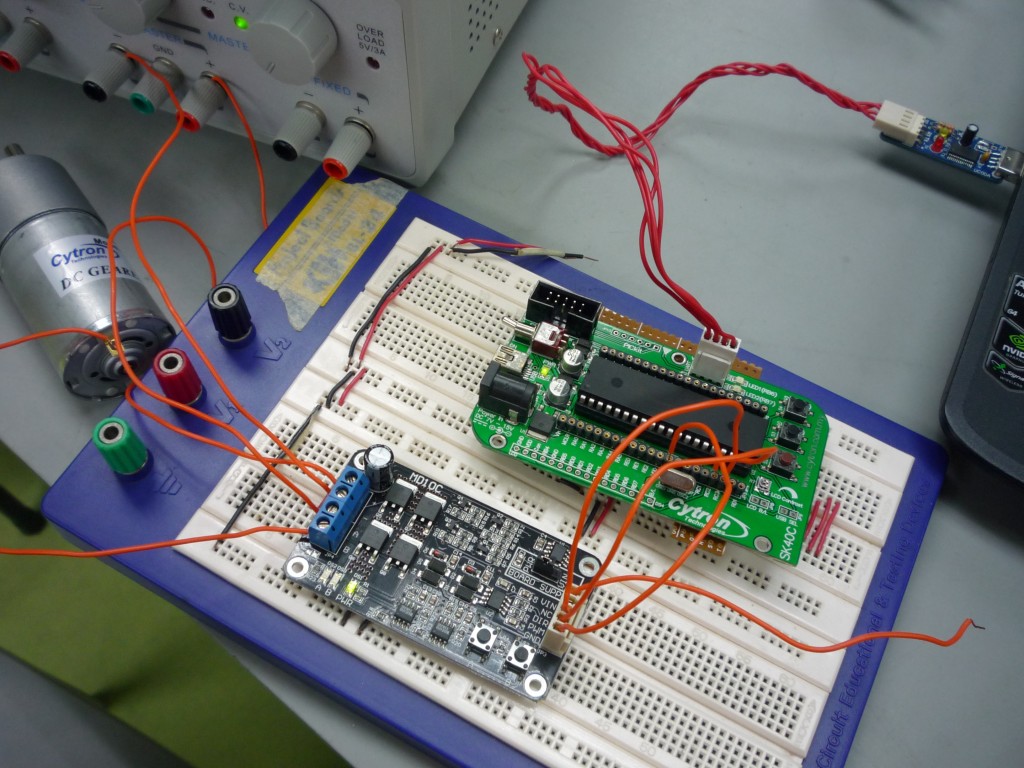

To be safe, I made a new circuit set up as shown in the picture below. Now, MD10C is powered by the power supply (14V) where the jumper is set to PWR. SK40C is powered by UC00A. The program is still the same as mentioned above on the paragprah with the double star at the end (**).To my disappointment, the circuit didn't work out like it should.
Latest circuit set up

My fear that there will be a problem turning the motor became true. The motor turned, but it wasn't smooth turning. I noticed that the A and B LEDs on MD10C were both lighted up, but one is brighter than the other.
Suspecting that the problem is because of SK40C, I hold the VDD cable from UC00A, and as expected, the PWR LED turned on brightly. Hence, I redo the motor test while holding VDD cable, and then the motor turns smoothly. :D So, the problem was actually VDD cable loosely connected from UC00A to SK40C. So now, I can turn the motor in either direction by sending either number "1" or "2" from HyperTerminal :D . Below is the hardware setup.
Latest hardware setup
