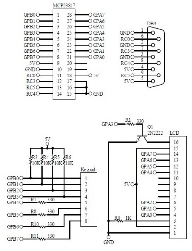

Postby shahrul » Tue Apr 09, 2013 9:17 am
I was interface LCD and keypad throught I/O Expander MCP23S17.
The code was successful read keypad and display LCD, but the problem is when I off and on it's cannot display.
Below schematic and code.
