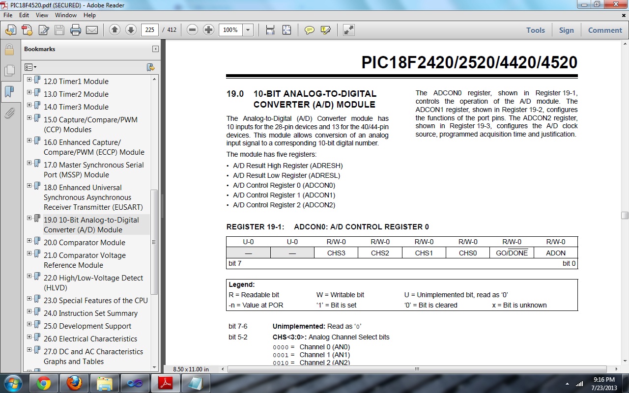

I am going to use a sensor which will produce analog output ranging from 0V to 5V. So I need to connect the output from the sensor to pin RA0 (AN0).
What should I do in the program code? Just configure ADCON1? What about ADCON0 and ADCON2? So far I just see people use ADCON1.
I use this instruction for setting ADCON1:
MOVLW 0x0E ; since I just only use pin RA0
MOVLW ADCON1
what I want is just the result in ADRESH and ADRESL register. I don't care the value, I just want to use the value for my if/else statement later in the code.
Please, someone..

All ADCON0, ADCON1 and ADCON2 have respective function. Refer address in the datasheet.
ex.
ADCON1=0b00000111;
ADCON0=0b00000001;
ADCON2=0b10000110;

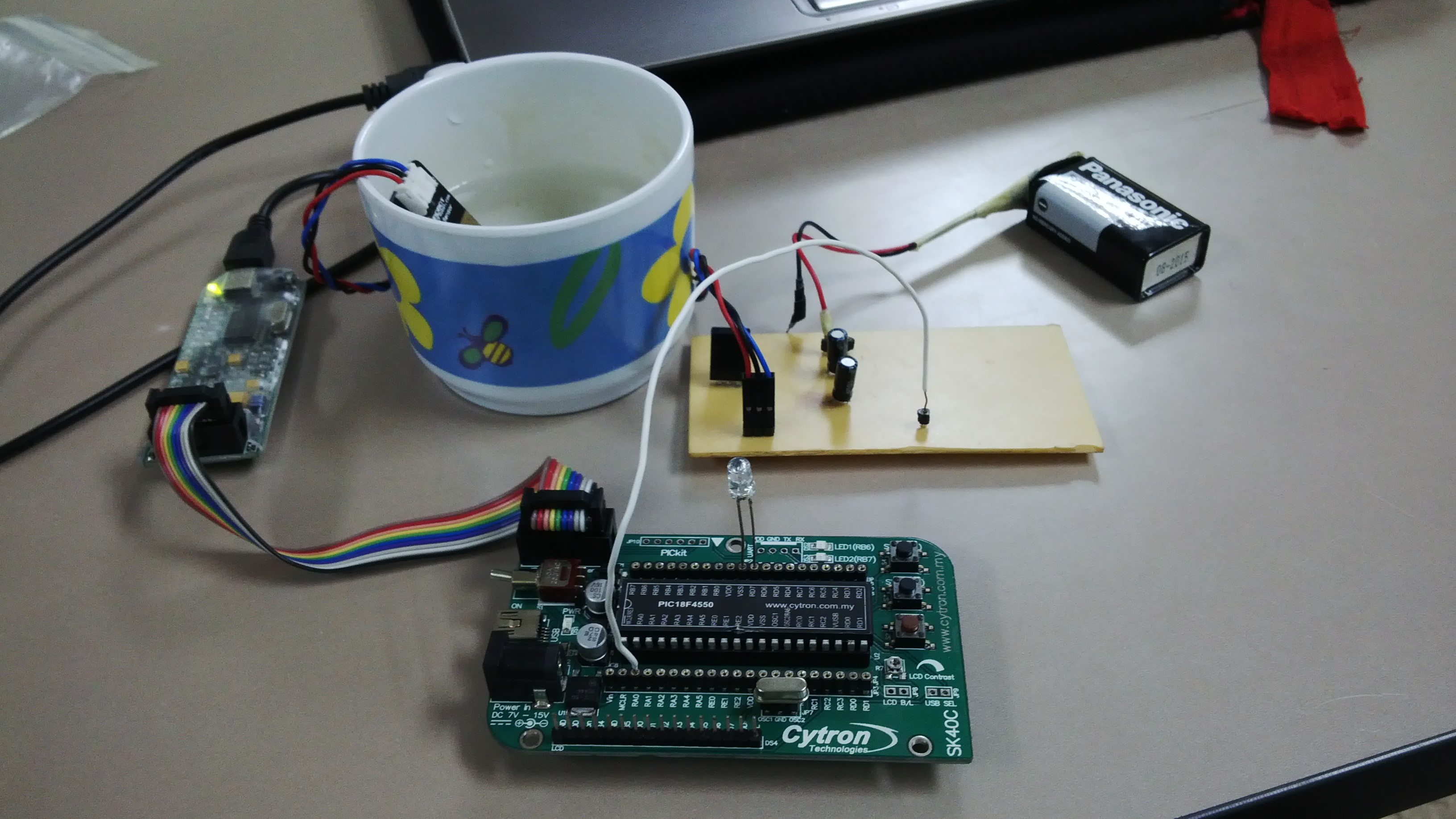

this is how the connection of input/output
white jumper wire is connected to pin RA0 as an input
led is just to show when sensor get immersed into water (in the cup), output will give 4.5V, and I want to use that output from pin RA0 to process if/else statement.
If output sensor 4V and above, led will light up, otherwise led will turn off.
So I want to use the value of ADRESH and ADRESL register to do this.
Any help?

mohdismiaswaly WROTE:this is how the connection of input/output
Any help?
Where is the gnd from sensor oh? How can the PIC know is 4V or 5V or any voltage with GND as reference ??
Help, you try first, then show us what you get.

Postby mohdismiaswaly » Fri Jul 26, 2013 4:59 pm
the gnd of the sensor is black jumper there on the uv board..it is connected to power supply (the regulator chip)..
the sensor just have 3 pin (Vcc, Gnd, Output)..so i just connect the output (white jumper) to the PIC (pin RA0 I am using AN0 channel in ADC)
ADCON0 set to 00000001
ADCON1 set to 00000110
ADCON2 set to 10000110
Is that correct?
Thanks
Is that correct?
Thanks
After that, start ADC conversion by set the bit GO on ADCON0<2>. Wait until conversion done and read ADRESH, ADRESL as the 10 bit result.

In register ADCON0, bit <1> is for GO. Are u sure bit <2> ?
Thanks

u will need to connect the gnd of the sensor back to the PIC as mentioned by robosang. or else ur sensor value read by PIC will be random value since there is common gnd on sensor and PIC.
depending on which pic18f u use, every pic mayb different
Re: HOW TO USE ADC IN PIC18F
Postby shahrul » Sat Jul 27, 2013 1:05 pm
mohdismiaswaly WROTE:In register ADCON0, bit <1> is for GO. Are u sure bit <2> ?
Thanks
Yes, bit <1>. I answer in hurry, not much time to spend here.. :)
